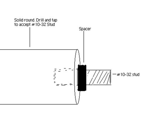

    I am going to attempt to fix the mag, using the stock mag parts and an allen nut. In order to accomplish that, I am going to start by fixing the button on my mill's vice. Using an endmill, I will open up the mag release button hole, large enough to be able to accept a nut.
    In order to have a nut that fits, I will have to trim down a nut. Here Is what I thought of to hold the nut on.
    I will make the tooling bar out of a drop piece of chrome rod. Lathe drilled and tap'd for a #10-32 stud.
    The nut Is tightened down against the spacer and cut with a single point cutting tool. The spacer is sacrificial, it is just for some tool releif. It could even be an extra nut.

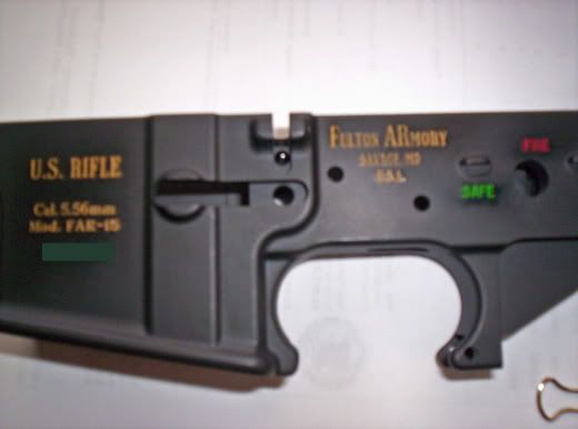

    Anyway. Thats what I'm going to try. Heres the "before" picture. I'll post more as the parts come in.

      Other than on the Fulton Armory website, that is the only Fulton lower I have seen!
      I have one myself, but the DOJ is holding it for me so I have not seen it yet.....

              You mean like this one:
              I am interested in to see how you plan one implementing your idea (in the opening post).
