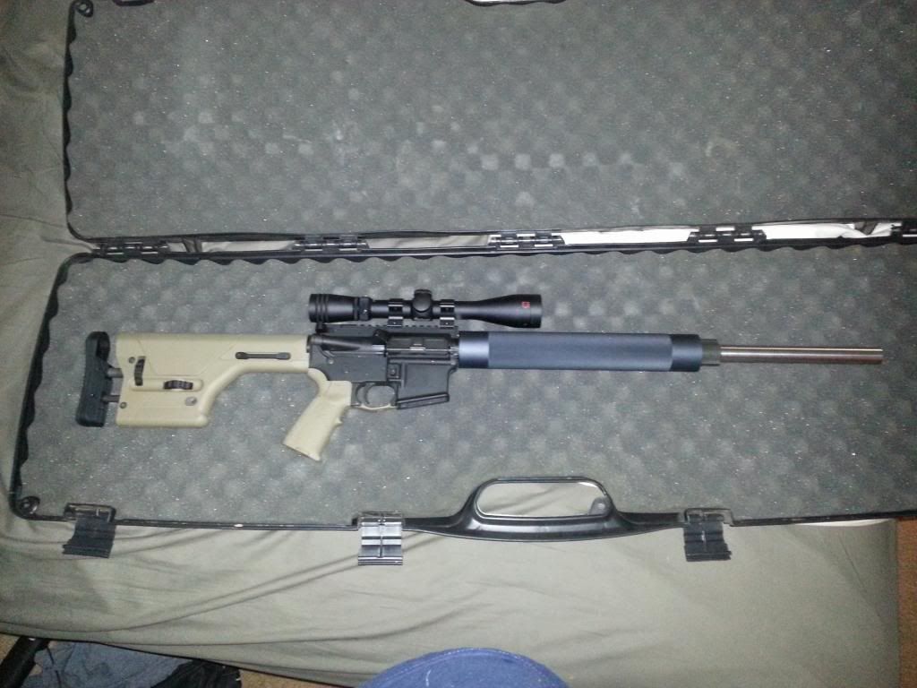

    I got my AR on 12/31/12. Today is the second day I've ever shot it. The first time shooting I never had a problem. Since then I have replaced the adjustable stock with a magpul prs fixed tube and buffer. The first shot is failing to load when I try to chamber it. The action doesn't close all the way and have to pull the charging handle all the way back or use the forward assist button. Did the gun store sell me too weak of a spring for the fixed buffer? Should I try to put my collapsible spring back in and see if it makes a difference? Or is the gun still too new and needs a break in period? I have 0 experience with AR's other then these 2 times out so I'm not sure what to try.

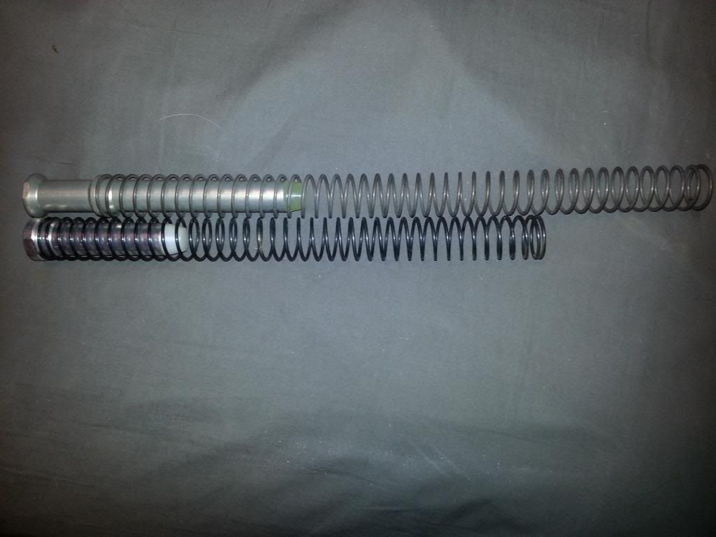

    I had the same exact issue with my Del-Ton when I purchased it. I then purchased a different spring that was 1 1/2 longer than the one Del-Ton gave me and the problem went away. Also try using FrugLube on the bolt and BCG and that will butter everything up.
    Also use a Mil-Spec Buffer tube its a bit shorter and it works better then a commercial, that is if you have a commercial tube.

      the PRS is a rifle length system.
      do you have a rifle buffer and spring?
      they are different than a carbine or mid-length system.

        Yes it's a rifle length tube and spring. I bought it from Sacramento Black Rifle. I told them exactly what I needed it for and what stock it was for. My best guess is it's the spring like TheDigitalPicasso said. So i'll start there and get some of that lube for it. Thanks for the feedback.

            Yes the buffer is 6 inch and the spring about 12.5. The lower one is the old adjustable commercial tube length.
              huh... that's weird.
              I was going to keep probing like "lubed up" etc... but it sounds like you know what you're doing so good luck tracking it down.
              Do your feed ramps match up? You're not mixing an A4 upper with an A3 barrel extension?

                    Clutchy, I do not know what you mean by the feed ramps. I have a cmmg upper with a 22" bull barrel. I'll add some gun oil on the CBG, I have not cleaned it, and there's maybe only 400 rounds total through it right now. So maybe a break in period is needed?
