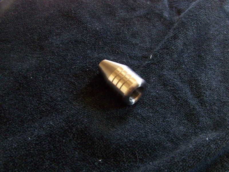

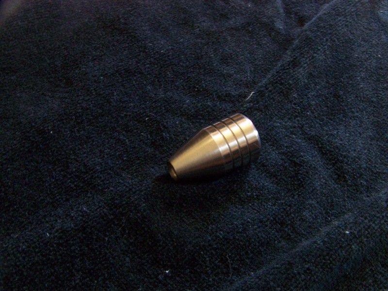

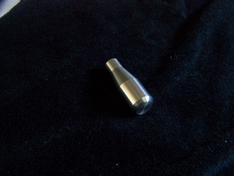

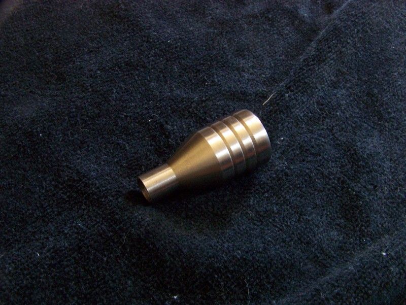

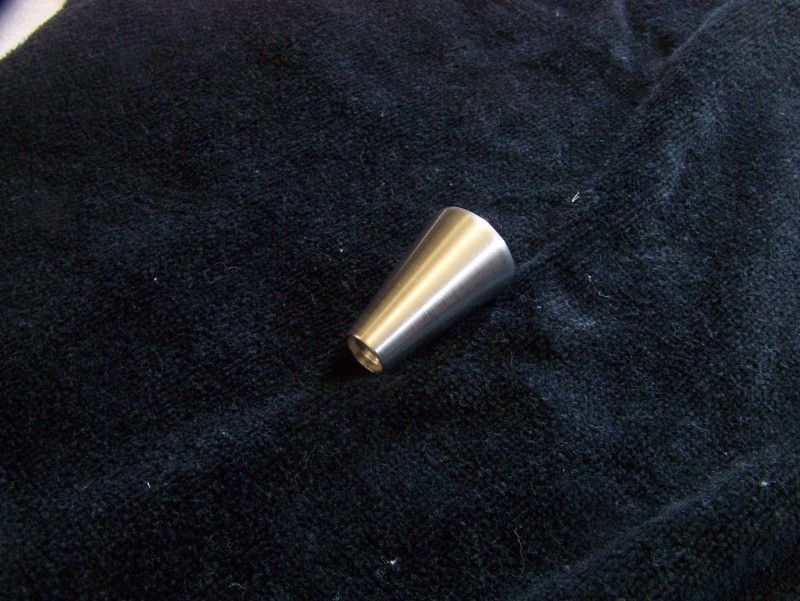

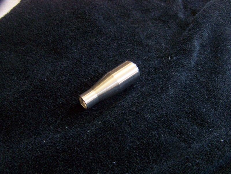

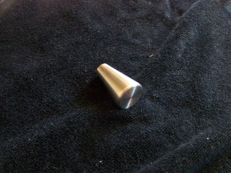

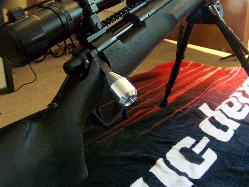

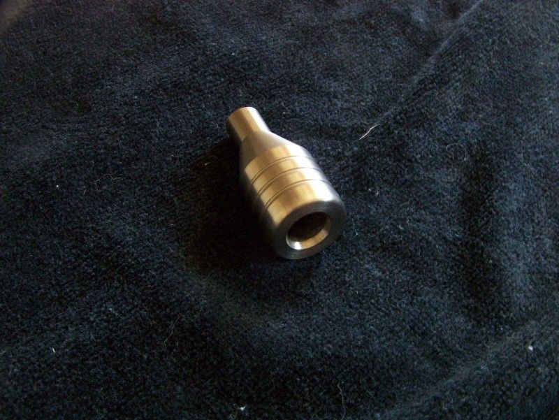

    I've been toying with the Idea of starting a firearms related company and I've decided I want to start in the custom bolt knob market. I'm not expecting to make a million dollars doing this, but I think I can offer a quality product at a competitive price and if I can establish myself it will open the door to further product lines and more business.
    What I'm asking is that you look at these bolt knobs and tell me what you think. Please, be honest, if you like them, cool, if you don't, let me know why. If you like them but think there could be improvements let me know what you would change.
    Keep in mind that these are in an unfinished state. They are made in my garage on a mini lathe and are not perfect. All radii are done by hand/file and the designs in general are born from me tinkering with angles and what I think might look good. If i go into business selling these they will be made with CNC machines and will be consistent, with a professional quality finish.
    These knobs are all threaded for a 5/16-24 stud, which needs to be either turned down from your original bolt knob, or your original knob cut off, and a stud pressed in and welded in place. The latter is preferred. Eventually I would like to offer this service myself, but initially, anyone who wanted their bolt modified for a custom knob could contact a qualified gunsmith and have them perform the modification. ar15barrels does a great job for only $40.
    I've posted a poll that allows multiple choices, however, there is only one submission. That said, if you like more than one style just check all the boxes you like and then click submit.
    Thanks for all your help!

    Originally posted by MelvinoelGreat**
    My friend, your Chargers sure are looking good tonight. They are only losing by 14 at the half, not to bad my friend.

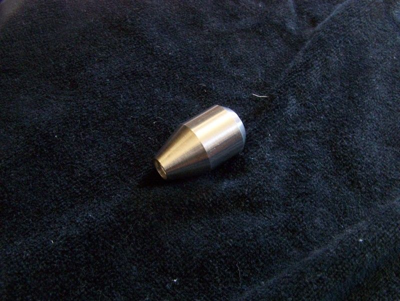

      Ok, that's it! blast away!

                  I like C but maybe bead blasted or something.

                    Thanks for the input! As said in the OP, these are all unfinished, so a raw bead blasted finish could definitely be something I would do. You'll notice the first 2 have a different luster, that's because they are stainless steel and the rest are aluminum. I'm thinking that raw finished knobs will be stainless, as it's much more resilient to scratches, aluminum knobs would likely be anodized for a more resistant finish. That said, there is no reason why any of them couldn't be made in stainless or aluminum. One thing to keep in mind is stainless is HEAVY when compared to aluminum, so if you're looking to keep weight down, aluminum is the way to go. I suppose there is no reason why the aluminum knobs couldn't also be offered in a raw finish, but the buyer should know they will be easily marred.

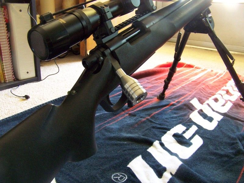

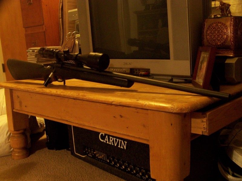

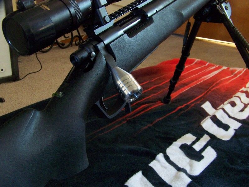

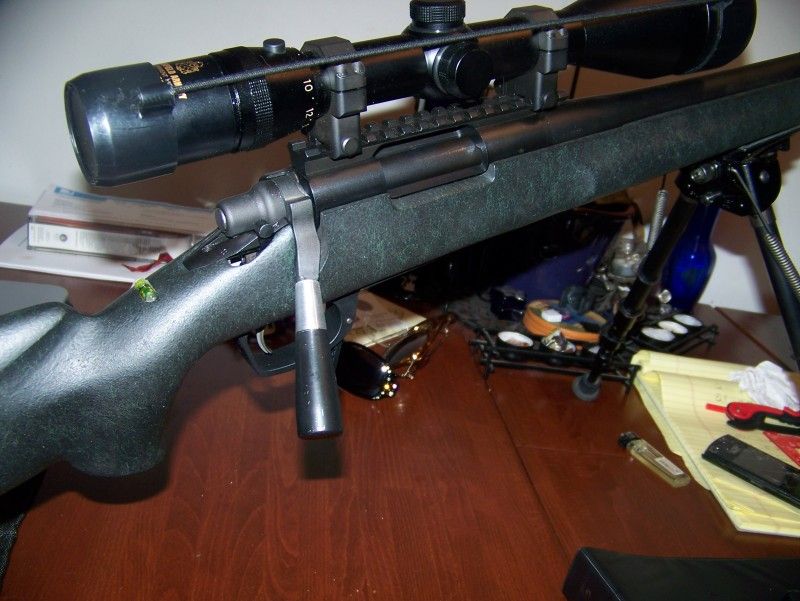

                              One thing I've learned is that there is a limit to desired length in terms of functionality. One of my first experiments named "The Kickstand" seemed like a good idea at first, but after playing with it for a bit I found the length was excessive and actually caused binding when doing rapid cycling. The leverage was great for opening/cocking, but the potential for binding was a deal breaker, IMO.
                              Thanks for your input!
                              Here are a couple pics of "The Kickstand:"
