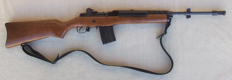

          Presume your GB is like this???

          MAKE SURE you get a thread checker and verify your thread count. OSH & $7 and it is in your tool box forever. Also mic the barrel for the proper diameter. The 'normal' AR thread is 1/2 x 28 and is misleading as my early GB (181 series) was 9/16 x 24. Calling Ruger just got me the wrong data as the older weapons have not been added to the database (I think they guessed).
          You might look at the Smith Enterprises Good Iron Muzzle Breaks. http://www.smithenterprise.com/ Good information and impressive videos.
          The SEI break is two pieced with a lock collar spun on first and then the break. Use the Mark 1 eyeball for alignment and lock it down. Test run a few rounds for functioning and if good, a drop of med Loctite is sufficient. YMMV, of course. Good Luck.
