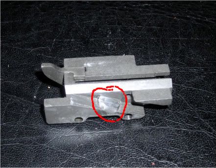

                            Originally posted by bahamablue72
                            Not a weld but more of a brazing. There is a bead of material that stops the magazine release from moving. Disassemble and chisel/file out the bead (softer metal then the receiver). It is slow going but take your time and it will come out.
                            I did this to my FAL last year. I was brand new to FALs when I did this and I was learning as I went along. So if I was able to do it, anyone can.
                            I have read that some have been fortunate enough to knock the bead off with a chisel and a firm whack but I was not so lucky. I had to remove the ejector block and file the bead down. To make things a little more difficult, the pins holding the e-block were extremely stubborn and would not budge with a punch and hammer. I had to drill through them with an undersized bit and then punch them out. After I had the e-block out, I was able to file the bead down pretty easily.
                            Here's the weld you need to remove.
                            If I were to do it all again, I would just remove the original e-block, toss it out, and install a new one. I actually did that earlier this year, I wish I had done that in the first place. I should have a handful of extra ejector blocks and pins if you think you may want to give it a shot.

                              Hi Andrewj,
                              Yea it was a bugger getting the block out. The top pin came right out, but the bottom just wouldn't budge. I put a lot of penatrating oil on it and let sit a week, then hit it with a punch & hammer. Came right out. Plan for this weekend is try the chisel trick first on the weld, then even if it doesn't take it out, go to the file.
                              BTW, it didn't have a mag release spring installed, so needed to order one, in case someone else takes on this sort of project.
                              Thanks again for the pic you posted!
