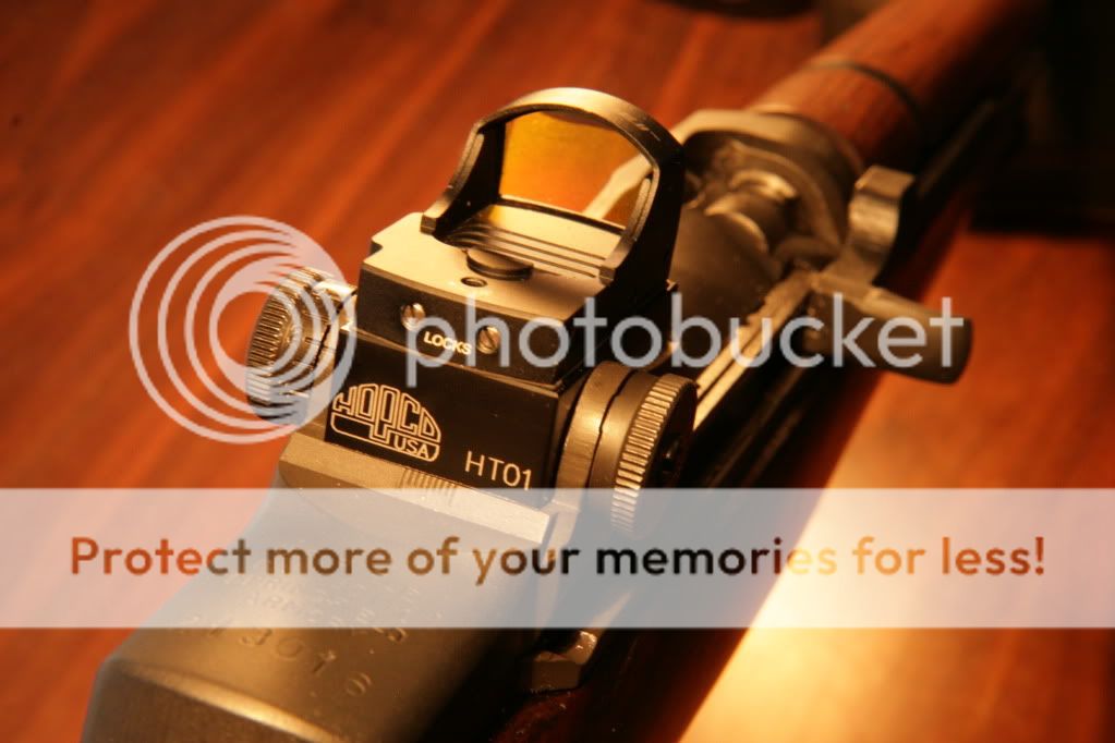

                The Hopco USA MRD mount puts the optic close to the bore so you can maintain a solid cheek weld without the use of a riser and keeps aesthetics of the rifle. Compatible with all M14 family receivers and there is a model for most micro red dots.

                  Be careful with a sight like that, because you loose the use of your iron sights (replaces your rear peep hole sight). I much prefer a forward mounted low dot if going with a dot, especially on a Scout, which already has a rail.

                    BTW, M14.ca offers the (RD) mount and it does have an iron sight tunnel.
                    They also offer the MRD mount that is similar to the one shown earlier and it also lacks a sight tunnel.

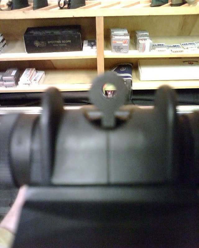

                        The MRD becomes a large ghost ring rear sight. We tested this and got positive results.
