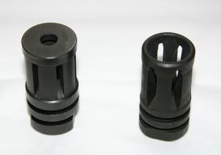

              Flash Hiders are wide open at the end. This design somehow helps the unspent powder burn before it becomes a giant fireball.
              Muzzle Brakes/Compensators are closed at the end with a hole just big enough for the bullet to go through. This design redirects some of the blast out the sides of the brake/comp which reduces recoil.
                  This is actually the reverse for M14/M1A's The opening of a FS on a M14/M1A is barely wide enough for the bullet and the muzzle brakes are wide open..
                    I think you are mistaken.
                    This is a M14/M1A Flash Hider
                    Note the open end.
                    This is a M14/M1A Muzzle Brake
                    Note the small hole, just big enough for the bullet to go through.
                    You can also see this in the Springfield Armory catalog here:
                    Look on page 42 to see the Springfield Brake.
                    Look on page 45 to see the Springfield Flash Hider.
                      Note the open end.
                      That is not a USGI M14 flash hider. The original has a much smaller hole. The national match spec actually calls for reaming the opening larger to avoid contact with the bullet.
                      The "approved" Springfield M1A muzzle break has a large opening on its end.
                        Correct.. the pic shows a reamed out NM FS... I believe the opening on a GI FS is around .320 a reamed out GI NM FS is about .460 as a SA Inc MB is about the same .460
