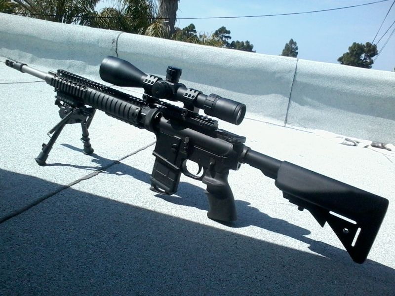

      A lot of your decision will depend on the amount of eye relief your scope has. I have a 3-15x50 Weaver Tactical on mine with 4"+ eye relief. The standard M4(SPR 1.5) mount geometry almost isn't enough with a fully extended SOPMOD stock. Figure out your eye relief and ideal location of your scope and that will help you select a mount.
      BTW, I ended-up going away from the LaRue mounts altogether(on an otherwise complete LaRue rifle) in favor of an extended, canted riser and rings. It is rock solid and has worked amazingly well.

                  I think the general idea is that the receiver and handguard should be in perfect alignment, and the only way to ensure that is to use a monolithic upper. In my case, I needed something with more forward throw than the LT104 and less throw than the LT139. I just decided to go with this setup because it gave me the most flexibility. That extended riser holds tighter than any quick release mount. If you can get past the fact that it isn't as Gucci as the LaRue or ADM options, it's probably the best way to go.

                    I think most are warned about bridging the gap because even if the rail is in perfect alignment there could be enough flex in the handguard to effect your zero and on a long range setup it doesn't take much.
                    There are add-on rails that solve this problem.
                    Droppin Dueces, by the looks of it, your add on scope rail isn't even attached to your handguard. Am I seeing that correct?

                      It is not. It's functionally identical to the LaRue style mounts, except it's 100% adjustable and tailored to my needs. I might never go back!
