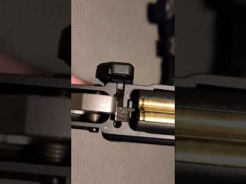

    For those with multiple builds, this is a great way to not spend a fortune to outfit them all. Initial investment about $10-15 (providing you already have a drill), and each subsequent build will be less than $1!!!
    Those of us that have been around awhile have seen and experienced having to use multiple devices over the years to stay compliant. I shared this a couple years ago, figured I would share again since I run into folks often complaining about the extra costs associated with the newer CA Compliance devices for their pews.
    I've have previously used (I no longer use any of these kits and spent hundreds on all of this stuff now it's all worthless):
    • California "Approved" Lowers from Vulcan. They had a 10/20 Magazine that was glued in and a set screw in the front of the receiver.
    • Prince 50 Kit (set screw through the mag release button)
    • Bullet Button
    • Raddlock (like a bullet button, but better)
    Other option:
    • Featureless
    After buying several different kits for each build over the years I was looking for the least expensive way possible to outfit my builds. When you go to a free state, you can simply remove one screw and you're all set. Takes 10 seconds. Before coming back, simply replace the screw, takes 15 seconds.
    Tools & Parts Needed:
    Drill or Drill Press
    4-40 X 1/2" Set Screws (0.65 each at the local hardware store as of this post)
    4-40 Tap & Tap Handle (can be found along with drill bit under $10 online as of this post)
    #43 Drill Bit
    Oil/Cutting Fluid

      Just make sure that the setscrew which keeps the mag release from working is not removable without "disassembly of the action" as required under the current law.
      A standard mag release button with a 4-40 setscrew added parallel to the 10-32 threads fails the legal test because it is accessible without disassembly of the action.

        Appreciate the tidbit, if you watched the video you would already know that the set screw is not accessible without disassembling the action of the weapon.

                  Okay, so here is an illustration of how I would make mine Ca Compliant...this of course requires disassembly of the firearm and a tool or tools. I used aluminum rivets and inexpensive magpul polymer mags. The hole is drilled right through the front center of the magwell just behind the front takedown pin. I would then insert my magazine and use the existing hole as a guide to drill into the seated magazine. I would scrape off whatever burrs where visible and pop my aluminum rivet in place. Aluminum just made more sense to me than SS simply because it is easier to drill through or file down in case it needs to be removed or replaced without compromising the receiver or the mag. The red arrow points to where on the receiver I am referring to and the white dot represents the location of where I would install my rivets. A box of rivets was like $1.89-$3.29 and most of gun owners/enthusiasts already own a drill/bits of some kind which is all that is needed...oh, and a punch. Once the firearm halves are assembled and the front take down pin pushed in you can't easily see the rivet (you can paint it black with a sharpie) and you definitely can NOT remove it without without tools and without disassembling the firearm. I had many side loaders loaded up, they were easy to carry, simple to use, and I never experienced any failures so it really worked well for me ..your experience may differ... Hopefully it'll help somebody if not, I hope it serves as an example of what not to do lol.
                  The access to the parts like the rivet without disassembly of the action is what would concern me here. All of these things are up for interpretation obviously and will be interpreted by those that most likely don't want us to have these types of arms.
                  My method requires disassembly of the action to reach the set screw. And the biggest benefit is that you can remove this screw (you can remove or replace it in seconds) when in a free state or WROL, and replace it as soon as you come back to your ban state and/or ROL is restored. All of these types of things are ridiculous and unconstitutional.

                          While in California I will either do a break action by releasing the rear pin and tilting the upper forward, or remove the upper completely just depends on what I'm doing and what caliber it is. These are great for transitions drills. Let a buddy load a random amount of seeds in there and go run a drill. Transition when you run out.
                          The idea behind this type of setup (for me) is that you have something that keeps you "compliant" for very little investment and you can change it very easily in seconds when you're out of California, then change it back very easily when returning to California.
                          This is especially useful for those that have multiple builds. Some of the other newer kits can run you up to $100 each. If you have 10 rifles, that's $1k. You could build a whole other rifle for $1k. Not to mention we've already seen the state make other methods of "fixed" magazine no longer viable like the Prince 50, Bullet Button, Raddlock etc.
                          Initially I had the CA Approved lowers from Vulcan which had a magazine epoxied in place along with a set screw through the front of the receiver into the magazine. These cost quite a bit more than other OLL's at the time. Then I went with Prince 50 kits, these were like $20 each, then Raddlocks I think these were like $40 each. So it's nice to spend less than $1 for each new build.
