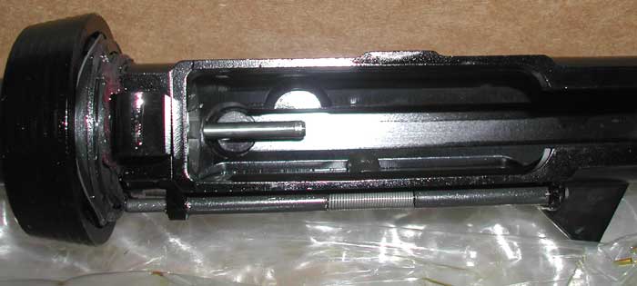

        Sounds like something with gas system. The gas key of your bolt should make contact within the gas tube.
        This is general pic of how much gas tube should be sticking into the upper receiver
        You can see this happening if you shine a light and slowly lock the bolt in.
        If the gas tube seems to correct length then either the gas tube is plugged/blocked or not correctly installed on gas block.
