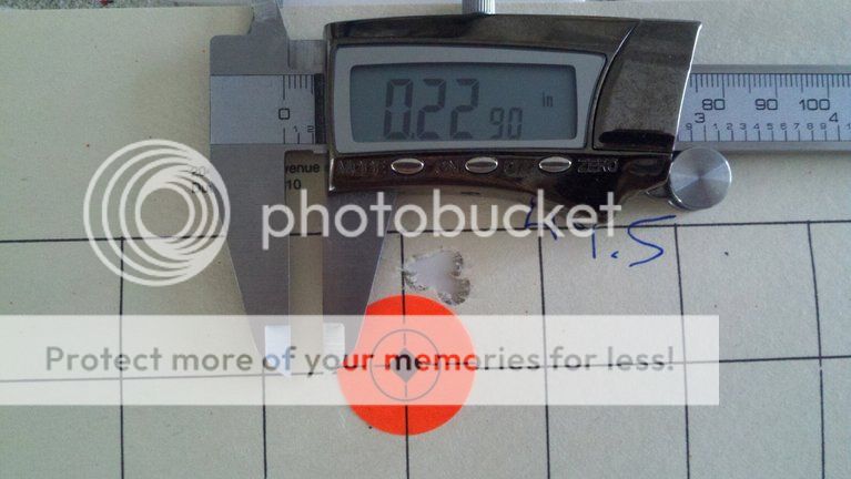

    When I build a rifle I build a load to pair with it. My latest build was a Savage 111 in 6.5-284Norma. While looking for a powder to use where else would I go but to the pros. The fav powders... 4350 and 4831sc. Worked up loads of each and the fastest I could push 140gr VLDs were 2850fps before seeing pressure signs. The faster I went the worse my groups got. I settled for 2850 and 1/2MOA.
    The past 6 months I have been hearing about this new powder that is giving faster speeds, up to 200fps more with less pressure. Sounded to good to be true and more internet gossip but the rummer increased month after month. Despite having plenty of 4350 and 4831 I let curiosity get the better of me and I ordered 5lbs of Reloaders 17. All I can say is HOLY COW PIES!!!!!
    Decided to load light for my testing and start at 48gr and increase by 0.5 up to 50.5gr. Most people seem to settle for 50gr at 3000fps which was my target too. Also heard R17 does not like to jump so I loaded the bullets all the way out to the lands with a OAL of 3.2950.
    5 shots of each....
    48gr avg: 3018fps
    Group size: 0.70
    Notes: No pressure signs at all. Vertical group string. High velocity deviation
    48.5gr avg: 3067fps
    Groups size: 0.65
    Notes: No pressure signs. slight primer flow into firing pin hole. Vertical group string. Slightly less velocity deviation than 48gr
    49gr avg: 3110fps
    Group size: 1.04
    Notes: sticky bolt, Increased primer flow into firing pin hole. Horizontal groups string. Even less velocity deviation than 48.5gr
    49.5gr avg: 3158fps
    group size: 0.22
    Notes: Stick bolt but less than 49gr. Primer flow same as 49gr. Horizontal group string. Even less velocity deviation than 49gr.
    Decided to go no higher as the speed and pressure were getting to high for my liking.
    Not sure what the hell happened with 49.gr but 49.5gr seems to be the winner.
    Thats an increase of 308fps giving 200ft-lbs more energy at 1000 yards than my previous load!!!!!! My rifle has been bumped up to a whole new level. My ballistic cards are all now worthless and I'll have to do the math all over again. My biggest problem now is to figure out what to do with all my 4530 and 4831 powder

          The pressure is not that high. When I say "sticky" I mean slightly above lift on an unfired cartridge. I have felt hot loads and this is on the very low end. I'm not even getting flattened primers so I feel good about it.
          As for barrel life I'm not too worried. I've only planned to shoot this barrel for 1000 rounds and I'm already at 700. I'll set it back .5" on each end when the accuracy goes to hell but I'm already planning on ordering a new Shilen barrel next month for when the set-back barrel burns out. Beauty of savage is I can swap barrels all day long

                    Honestly, I don't know, I only had 5 rounds of that load. I was mainly shooting to test speed and pressure. It could have been a fluke. After doing a detailed inspection of the brass I think I'm going to drop down to 48.5gr. There was too much flow with 49 and 49.5gr. Not worried about the rifle but the cost and availability of brass. At 49.5gr i'd be lucky to get 3 reloads out of them. If I drop to 48.5gr I should be able to get at least 7
