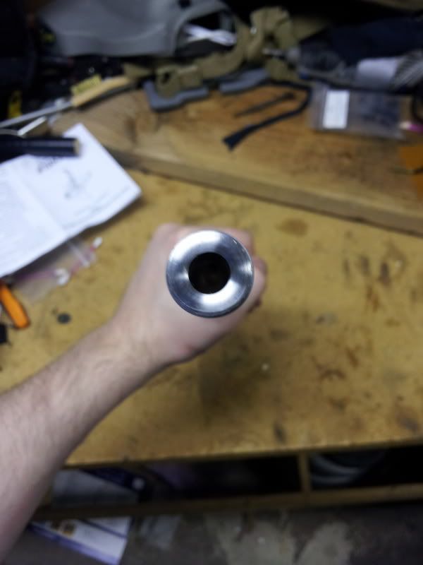

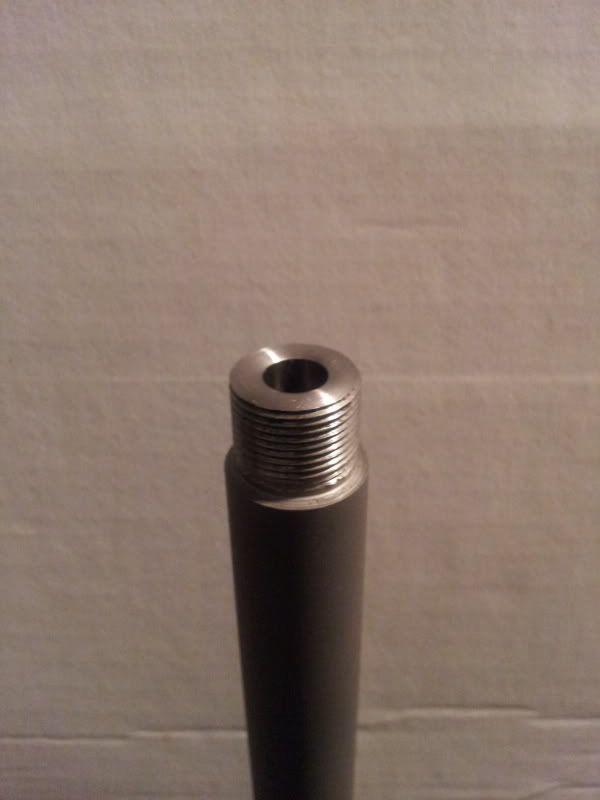

    Then I notice the crown has some little tooling marks. Uh....haven't I heard that the crown is ONE OF THE MOST IMPORTANT THINGS EVER IF IT'S BARELY NICKED YOU'LL LOSE ALL ACCURACY etc etc etc?
    So here's the pics. Like I said, it's tooling marks. There are some curved light scratches that look like they came from machinery, and there's two slightly rough spots. It's minor, it really is. There's no 1/8" gashes or anything, and the marks don't touch the bore. I just want to make sure before I continue to build this rifle that this is fine, won't screw my accuracy, and I shouldn't be calling BHW in the morning. Thanks!

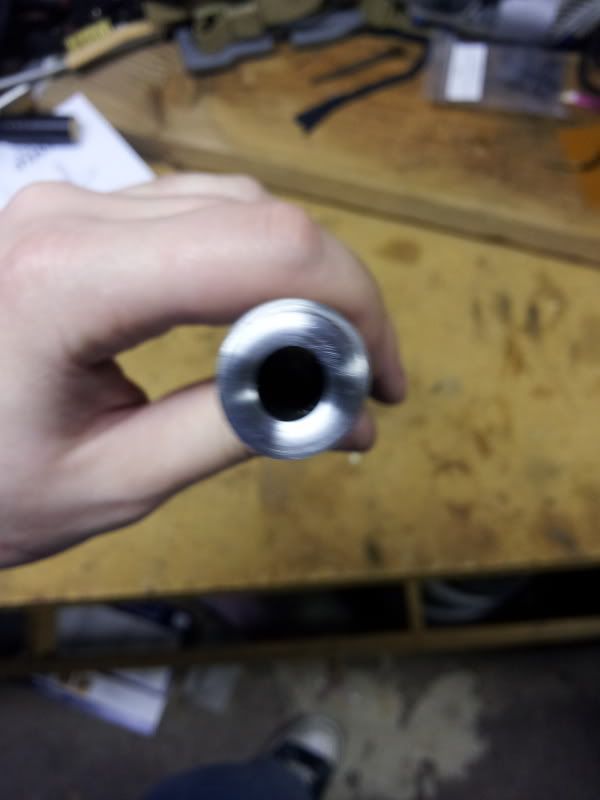

    This one's blurry, but oddly enough easier to see.

    I can't even see the crown in those pictures

      Any suggestions on how to coax a better picture of a highly reflective surface using a camera phone? :P

        Try a shot that is not so straight on

          If the marks don't touch the bore why do you think it would affect accuracy?

            So that's my whole point. I don't think it'll be a problem, *but I wanted to be sure before I shot it*. People talk about how MASSIVELY IMPORTANT a FLAWLESS MUZZLE is, just wanted to make sure. :P

              I don't know if I would consider that a "precision" barrel, but if the scratches aren't in the area where the rifling transitions to the muzzle you should be okay. Shoot it and let us know!

                Scratches on the surface aren't a problem, it's the lip of the muzzle where the bullet is initially free of the rifling that is the problem. If you have any burs or deformations there you'll have accuracy problems. That's why a crown is cut recessed (usually 11 degrees from the muzzle plane): to protect the lip of the muzzle.

                    It's bore, bevel, then crown. The bore transitions to the bevel that's the most important part to look at, and what you are seeing with the tooling marks is the crown.

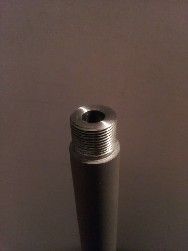

                      Better pictures, in case it makes any difference.

                        Looks clean to me. Throw a brake on there and go have some fun

                            Just shoot it. If your accuracy is affected, there's your answer.

                              Looks fine but if you're really concerned, take it to a smith and have it recrowned before you mount it all up.
