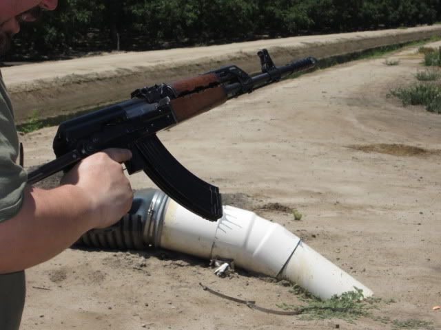

                  I have one of those, my gun ran fine using it.
                  Here's a pic 69Mach1 took of my M70.
