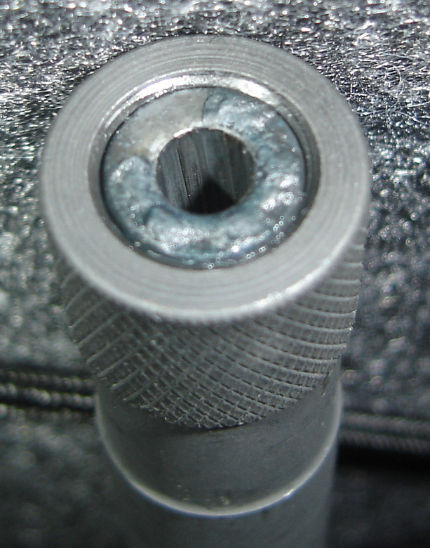

        OK here's a pic of the muzzle:
        This is a brand new Stag, shown with a thread protector on it. Notice that the upper left quarter of the "crowning" is missing. It was not that way when I first got it. I noticed this after I had fired 120 rounds through it.

          That "slag" is carbon buildup.
          The area where it's missing is your actual muzzle.
          Use a brass or aluminum scraper to knock the carbon off.
          That upper did not always have that thread protector on it.
          You only get buildup like that when you have a muzzle device on it that captures the carbon.
          That's a LOT of carbon for only 120 rounds.
          I suspect there are either more rounds through it, or you are shooting some crappy ammo that makes a lot of carbon buildup.

              I bought the upper/barrel brand new with that "build-up" on it. WTF?
              (And I put the thread protector on it.)

                I hate to break it to you, but the barrel was certainly NOT new when you bought it if it had that buildup.
                I would estimate that carbon buildup is from about 500 rounds fired and there was certainly a muzzle device on there when those rounds were fired.

                  I buy alot of used AR parts, some better than others, And i've never picked up anything that had that much carbon on it.
                  Heck even my beater guns that I run wolf ammo through don't get carbon on them like that (and I have linear compensators on some of them)
                  I'd say if anything Randal's understating how used that looks.
                  Methinks you've been rooked.

                    I was going to say 500-1000 rounds at first, but I really don't know for sure so I estimate on the low end as to not hurt his feelings as much.
                    I have seen barrels with 5K rounds fired without ever removing the muzzle device and they had
                    over 1/16" of carbon built-up in there, filling ALL the space between the muzzle and the inside of the muzzle device.
                    I took a picture of that, but I don't know where it is right now.

                      Yep. Carbon. I just spent the last hour with a brass brush and I still only got 80% of it off.
                      I bought this upper assembly with barrel new from Wes at Ten Percent. Now Wes is a great guy so all I can think is that Stag put a used barrel on a new upper. But based on how crappy the upper has performed (see my first and earlier posts) maybe the entire thing was a return that they resold. This was the second one Wes sent me, because the first one was a 3L with 3H tags on it in a 3H box.
                      At the very least, Stag better give me a new one. Better, I want to return it for a refund. My taste for Stag has been totally soured at this point.
