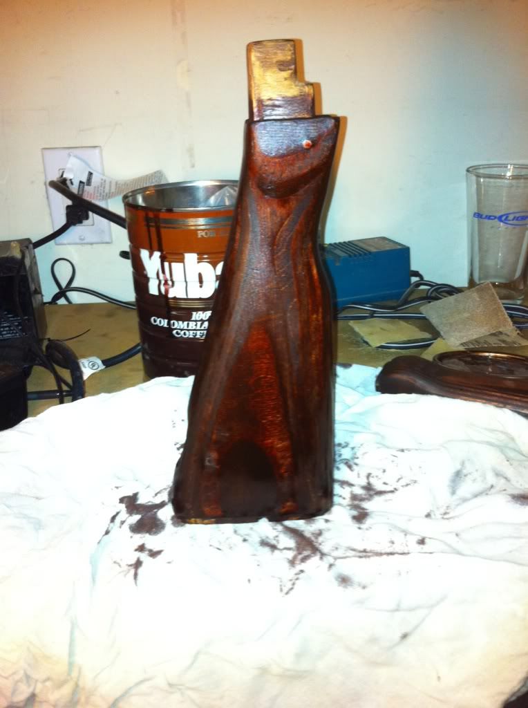

    Oh, and here's the stock all stained up
    (anyone know a good clear coat to use with it? Its some minwax red mahogany stain)

    I followed the advice of stock refinishing sticky in the Gunsmithing forum, and used Minwax Wipe-On Poly Coat for the clear on my AK stock. After 4 coats it seems pretty durable and it is shiny. I learned one has to be careful when sanding the first coat, because it's easy to go too hard and mar the stain finish.

      Did you only sand after the first coat or in between every coat? Also, the clear we had put on before turned out really milky so i sanded it all down to wood again, do you recommend that I put another stain on it too now that I'm down to wood?
