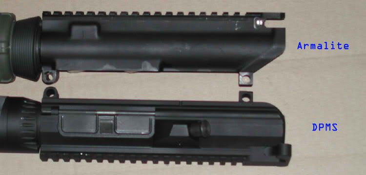

              Picture ... thousand words ... etc ...
                So, thats the difference, DPMS puts the charging handle on the bottom instead of the top of the reciver....LOL
