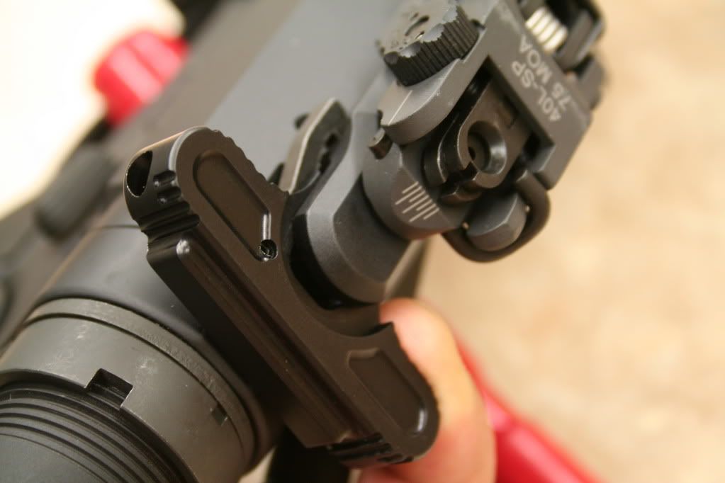

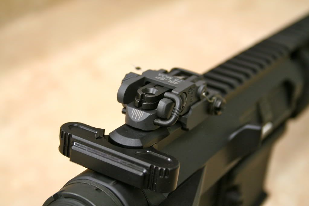

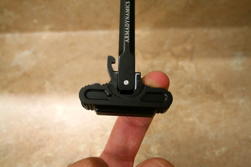

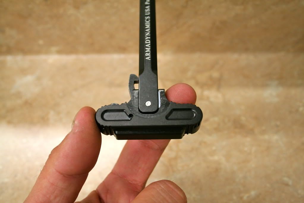

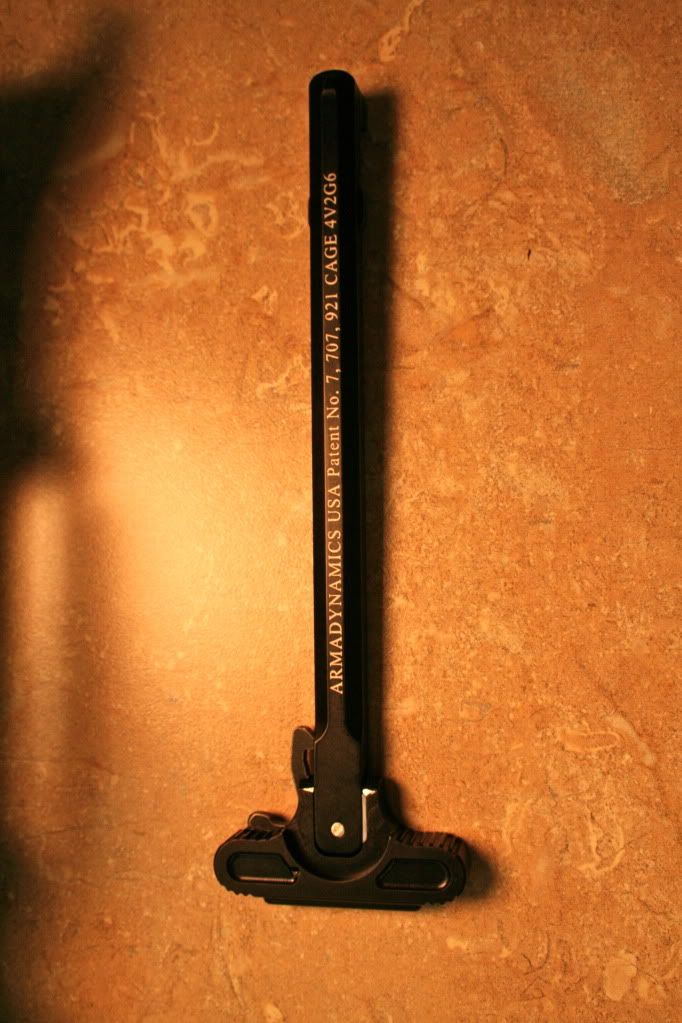

    I recently built an AR for friend. He wanted a ground up for his first rifle and we spent days going over all the different types. He is a reserve Marine so he has shot the basic M-16 but wanted his own to be built to his specs. The rifle turned out beautiful, but... he is a lefty and i found him an ambi charging handle from Armadynamics. It is very nice ch! He bought a Sun Devil upper/lower witch is nice as well. But it doesnt work in the Sun Devil upper. He is also using an Adams Arms gas piston system as well.
    So. What ive done:
    1. tried his ch in my Larue upper WITH Adams piston---works fine
    2: tried his ch in my Bravo Co upper with Adams piston---works fine
    3: tried his ch in my wifes Rainier DI upper---works fine
    4: tried his ch in another DI upper i built---works fine
    So. It worked in two other billet uppers, one DI, one Adams piston---works
    It worked in two other forged uppers, one Di, one piston---works
    ADVICE PLEASE. I havnt totaled the build, but he is in the rifle over 1500 dollars. I would really love it if ya'll might have some advice to get this to work. Thank you for your time.

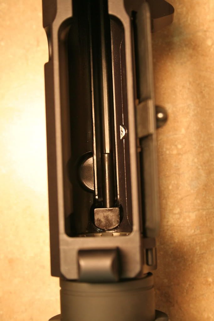

      On a serious note, maybe his gas tube/stripped upper is mid align somewhere?

        So from the pics it looks like it goes all the way in, hits, but doesnt go deep enough for the lock to engage on the left?
        If so maybe file/sand the tip slowly and carefully to "shorten" it.

            I have the same charging handle on a SunDevil upper and it works fine with a gas tube (It's a great charging handle for a lefty!). That said, I've been reading that the Sun Devil Uppers are out of spec on the grip mount (doesn't fit well with the hammerhead grip, which I found out the hard way!), so perhaps there is an alignment issue with the receiver/piston? I would contact Adam's Arms, Sun Devil and ArmaDynamics to see if any of them have seen this issue.
                very well may be. it was a helluva time pounding the shim in and the ch works fine without the gas rod installed. as best as my eye can see and as best as my level works, the upper and the gas block line up perfectly

                    Perhaps I'm alittle slow or I just missed it... but I don't see anywhere where you mention what exactly doesn't it do (other than it doesn't work). Perhaps alittle more clarification might get you more help?
                      SpeedTribe
                      • Nov 2005
                      • 247
                      If it works (locks in?) without the piston rod I would look to make sure the piston rod is coming in straight and moves freely. Is the shim you had trouble with maybe a little crooked, which would cause the piston rod to be off center a bit, and it is interfering with the charging handle?
                        works standard, but not from the right side. (ambi)
                          as best as i can tell, the piston rod is straight and the shim is seated all the way. i had a friend look at it tonight and his conclusion is that the upper, gas system and the ch just dont mix. in a post above, they said that they were running a sun devil with the same ch and it worked fine. so i guess its just the combo he is running. thanks all for the help and input
