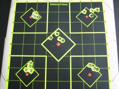

    Range Report:
    Rifle Specs:
    1) FNH SPR A5 rifle with 4 round DBM magazine, McMillan A5 Stock.
    2) 20-inch 1/12 twist, 4 grooves, 308 Win, hammer-forged, chrome-lined, mirror polished, chrome-moly, blued, fluted, barrel with match crown.
    3) Custom pillar bedding and devcon bedding job done by Calgunner - Kendog4570 (Gunsmith, Aptos, Ca)
    4) Installation of Badger Knob by Ken.
    5) Factory action, trued at the factory, unaltered.
    6) Factory-installed 20 MOA mount base.
    7) 3.5-lb factory stock trigger
    Scope Specs:
    1. Nightforce 5.5 - 22 x 50 NXS, Zero stop, MOA reticle.
    2. Nightforce steel rings
    Shooting Condition:
    1. from bench
    2. 100 yards
    3. no wind
    4. warm barrel shots (4-5 shot series, 20 seconds between shots)
    5. Harris bipod and with/without rear sandbag
    Result:
    1. Center: American Eagle 168 grain OTM, no rear sandbag, 0.95 MOA
    2. Left Lower Corner: American Eagle 168 grain OTM, with rear sandbag, 0.53 MOA
    3. Right Top Corner: Blackhills Match 168 grain BTHP, rear sandbag, 1.06 MOA
    4. Right Lower Corner: Federal Gold Cup 168 grain BTHP, rear sandbag, 0.57 MOA
    5. Left Top Corner: Hornady Match 168 grain BTHP, 5 rounds, rear sand bag, 0.42 MOA
    Second Range Trip:
    1. Bench and Prone with 168 grain Hornady BTHP.
    2. 0.43 MOA (4 shots), 0.6 MOA (4 shots), 0.26 MOA (4 shots) - (all bench)
    3. 0.59 MOA (5 shots) - (prone)
    Conclusion:
    A 1/12 twist, 20 inch barrel is probably good up to 700 - 800 yards with 168 grain bullets, not sure about 175 grain given the lower twist rate. FN's Chrome-lined barrel has excellent accuracy, but mine didn't like Blackhills ammo. FN SPR barrels are rated for 15,000 rounds to maintain 0.5 MOA. The Myth that chrome-lined barrel cannot be used as match-grade barrels is outdated; both FN SPR and SAKO TRG use chrome-lined barrels, both with great results achieving sub-MOA. However, these barrels are very different from M14 USGI chrome-lined barrels, FN barrel is mirror-polished whereas M14 barrels are pretty rough on the bore. Kendog4570 from Aptos did an excellent and professional pillar bedding job with turn-around time of only 2 weeks, and I highly recommend him as a licensed gunsmith.

            more pictures uploaded from my second trip to range.
