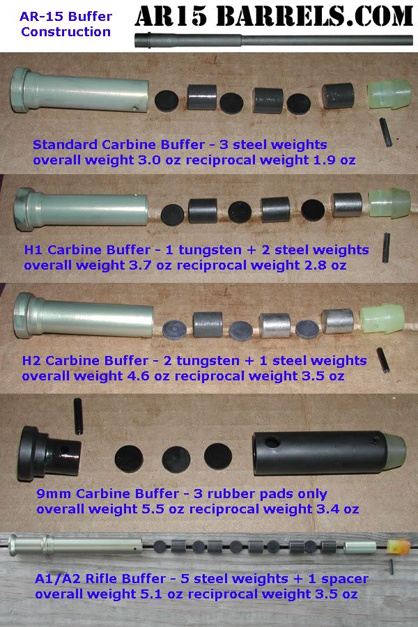

    I recently finished a build where I used an ATI buffer tube assembly and the darn buffer rattles. I've read a few other places that it's supposed to do that.
    "It's normal. The buffer alone doesn't have the mass it needs for reliable chambering. The rattle is caused by cylindrical weights about a half-inch long that shift and provide just a little extra "nudge" on the rear of the bolt as it goes to battery. The weights also act as a cyclic rate reducer by increasing the reciprocating mass."

    Did you swap buffers to see if it is the buffer itself or the tube?

      Good idea. I'd just pulled the buffer out and shook it and heard the noise.
      <<5 Minutes Later>>
      Yes, it's the buffer.

        I like the spikes buffer, it's full of sand like material. No noise.
        I have a few no name buffers that sound like a bag of marbles shaking around too, dont like em haha

            I got an ATI buffer that rattled so badly it made my buy a used LMT buffer from the Marketplace. That one also rattled. A bit less, but still rattled.

              Yeah, in a way I guess it does. I realize it's supposed to but why then don't they all...?
