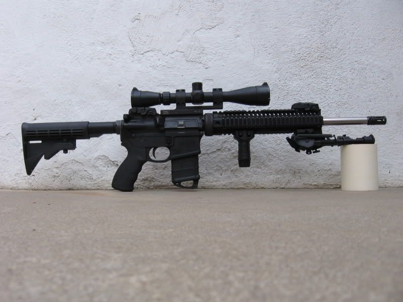

          I have more or less what you're talking about(16"/1:8/Wylde) except with a 3-9x40 scope instead of the 1-4x. I used to have a 1-4x and wasn't satisfied with it for the type of shooting I do, which is..well...shooting 500-600 yard steel.

            That looks nice. Hmmm gives me some ideas. I'm also thinking of putting on a 1 o'clock micro reflex sight.
                  That was something that I had originally planned to do, but I couldn't justify it. This is really just a bench gun for me(and a very good one). That VFG hardly ever gets touched. I might change the stock eventually for something a little onger, but I really like the M4 stocks - especially the LMT version that I have on there. They are rock solid.
