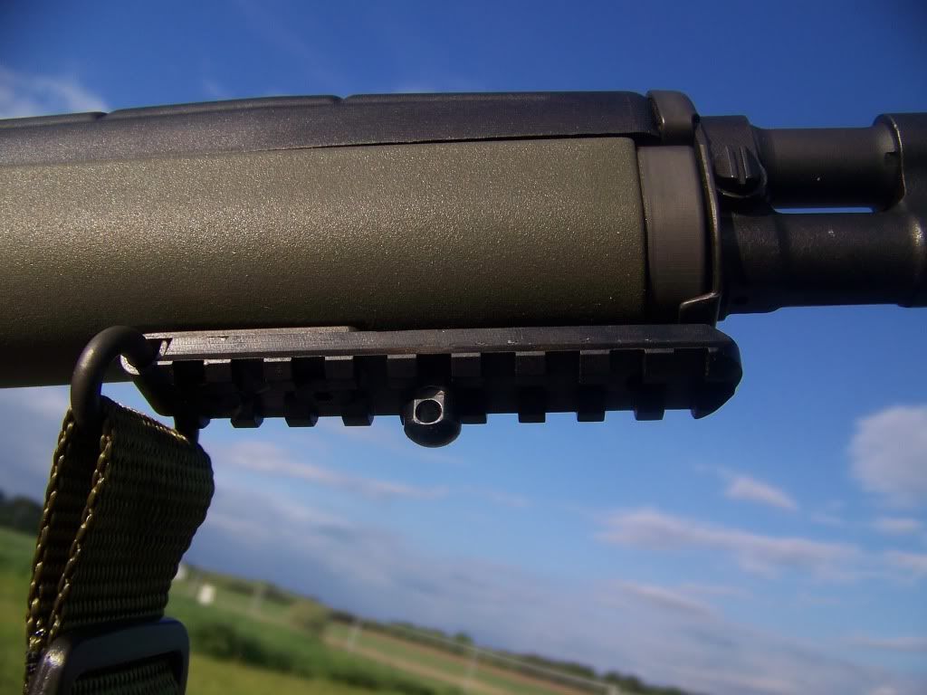

                      I decided to make one as I had several types of pictinney rails in stock. I started with a Mesa Tactical Receiver Length rail for the 870. Two of the holes in the rail match the holes in the forward swivel. So I cut the rail off and then enlarged the holes so the screws would fit. I then got very lucky again and two longer screws that I think were from CDM Gear Brackets I have in stock turned out to be the perfect length and same threads as the inserts already in the stock. I then went to a friends shop and got a Quick Detach stud with fine threads and a nut. I drilled a hole for this QD. The fun came in as I had to make a counter sink on the back of the rail and then grind the nut down. I could not quite get it down enough so it would not touch the stock, so I simply used washers from some Mesa shell holder install kits and put them between the rail and the existing swivel plate and these brought the rail up just enough to fit.
                      I can now use the pi-pod I had in stock.
