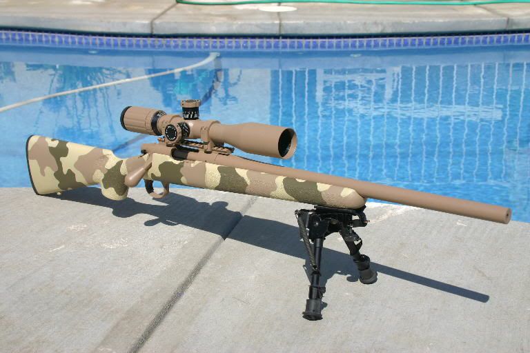

                        Here's one from R&D
                        Randy built three of my rifles and am very happy with mine. Here's my wife's semi custom .223
                        Here's the famous pool porn.
