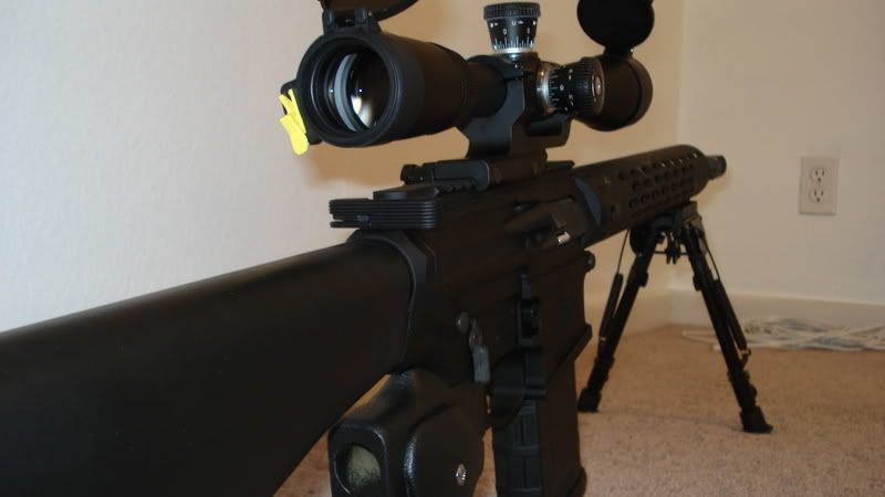

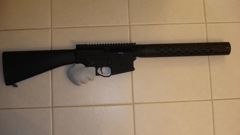

    Well after almost 7 months of saving researching, choosing, and bothering Jpach for advice here she sits, loosely assembled.
    I still need a Gas Block, Gas tube, and the dpms panther claw to assemble it completely. Some things in the photos may look like they are canted and thats because they are! Only things that are tightened are the lower parts. Tube, barrel and scope are just hand tight until I get the rest of my stuff. (next paycheck)
    Here are the guts.
    Mega Ma-Ten matched set from T&A Armory
    A2 stock 308 set from Midway
    RRA lpk with 2 stage trigger from Eagle Armory
    DPMS Ambi safety and DPMS 308 bolt catch Midway
    JD Machine tech free float tube in 14" with one rail section.
    Cheapo bipod (off my .22lr) for now. Will order EMA when or if it ever comes back in stock.
    18" rifle length barrel and BCG from Black hole weaponry
    Nikon 6-18x40 Buckmaster Midway
    Hammer Head grip Exile machining (cut down, but can not get a pistol style grasp).
    My custom grip that screws to the hammer head grip
    Dark Metal Design compensator
    I am excited for next pay check so I can order the last few parts I need. Then shooting!!!!!! Will report back with range report when I get to it.

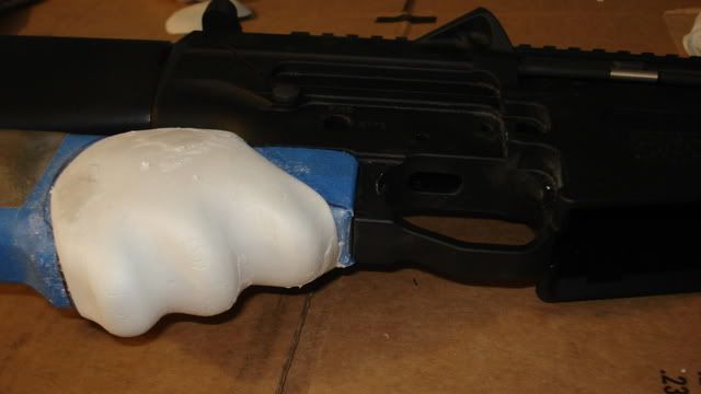

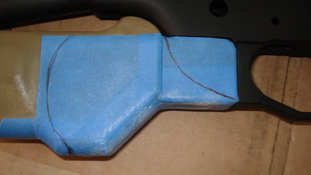

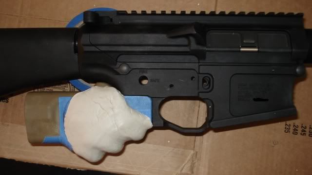

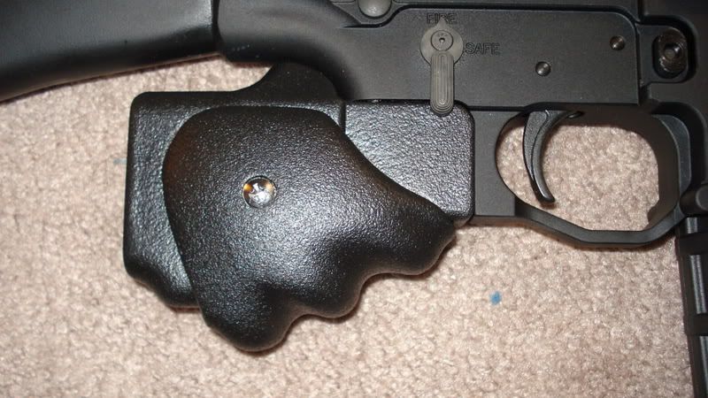

          This is the add on to the exile that I made.
          Here is my own that I am working on, when I have time.

                              Nice looking custom grip! This is a perfect application for the blemished Hammerhead. $9.99 and they ship free, while supplies last.
