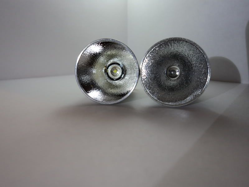

    LED on the left, regular on the right.

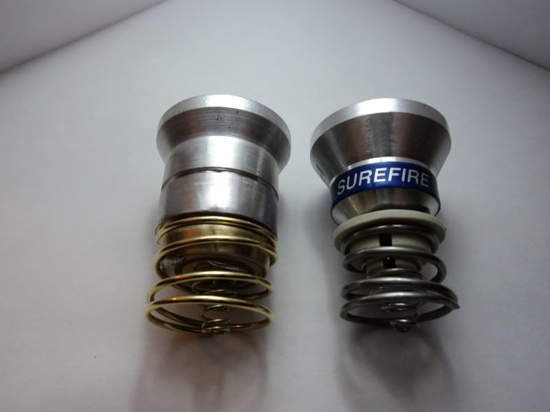

    LED on the left... I did NOT use the large spring. It would not fit. It even warns you in the sale it may not be necessary to use it.

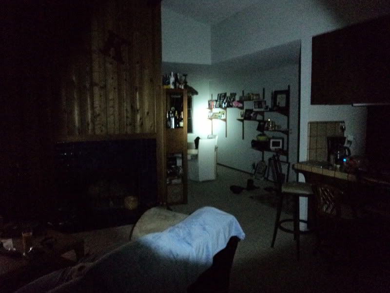

    indoor shot with the LED...

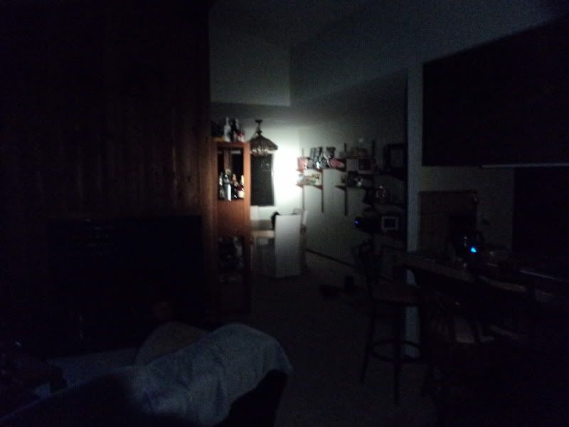

    indoor shot with stock bulb...

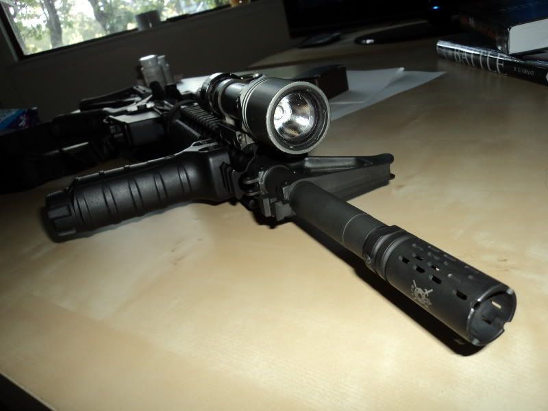

    mounted... tape switch didn't show up till later in the day... battlecomp pr0n at no extra cost

    Not the right section for a weapon light review, buy very good start. Take the rifle to the range with the weaponlight and turn the light on and start firing some off. see if you can tell if the light is turning off. The large spring is for recoil absorption. without it , it is possible the recoil overpowers the little spring and disconnects it from the battery pack. This is why some EOTechs need new springs (old EOTechs with in-line batteries). It may take several hundreds (5 or 6) rounds too see a problem or you may never see it.
    Good job on the pics, thats what people need to see. I was never a fan of LED until they started making them with a longer throw. Its nice to see a wide area of illumination, but I want distance too. Seems the CREE Q5 has distance.
    Like I said, the major issue would be the removal of the recoil spring, but less face it...its a .223 LOL not like its an AK or Mosin. The problem is rare, but exist.
