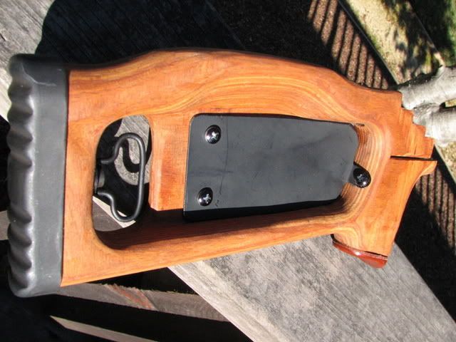

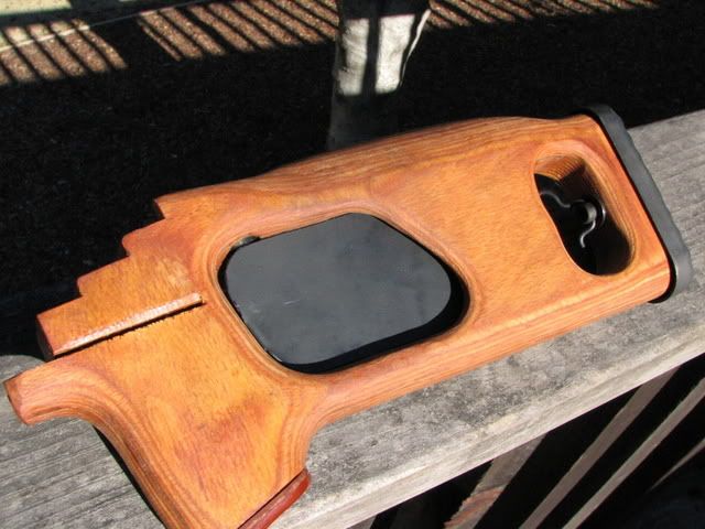

                In my case I just filled the gap between the stock and grip, but it's attached to the grip and not the stock. Duramix is a plastic filler that can be sanded and painted. I used the 4040 on the grip. And can be bought at auto body supply stores.
                here's the grip http://www.calguns.net/calgunforum/s...ad.php?t=58679
