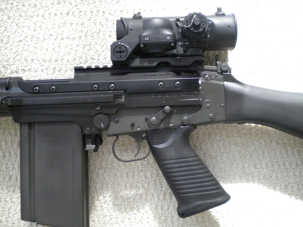

                      The DSA's extreme duty scope mount is rock solid. The screws do not tighten against the receiver like some cheaper models will do. Scope is an Elcan Specter DR.
