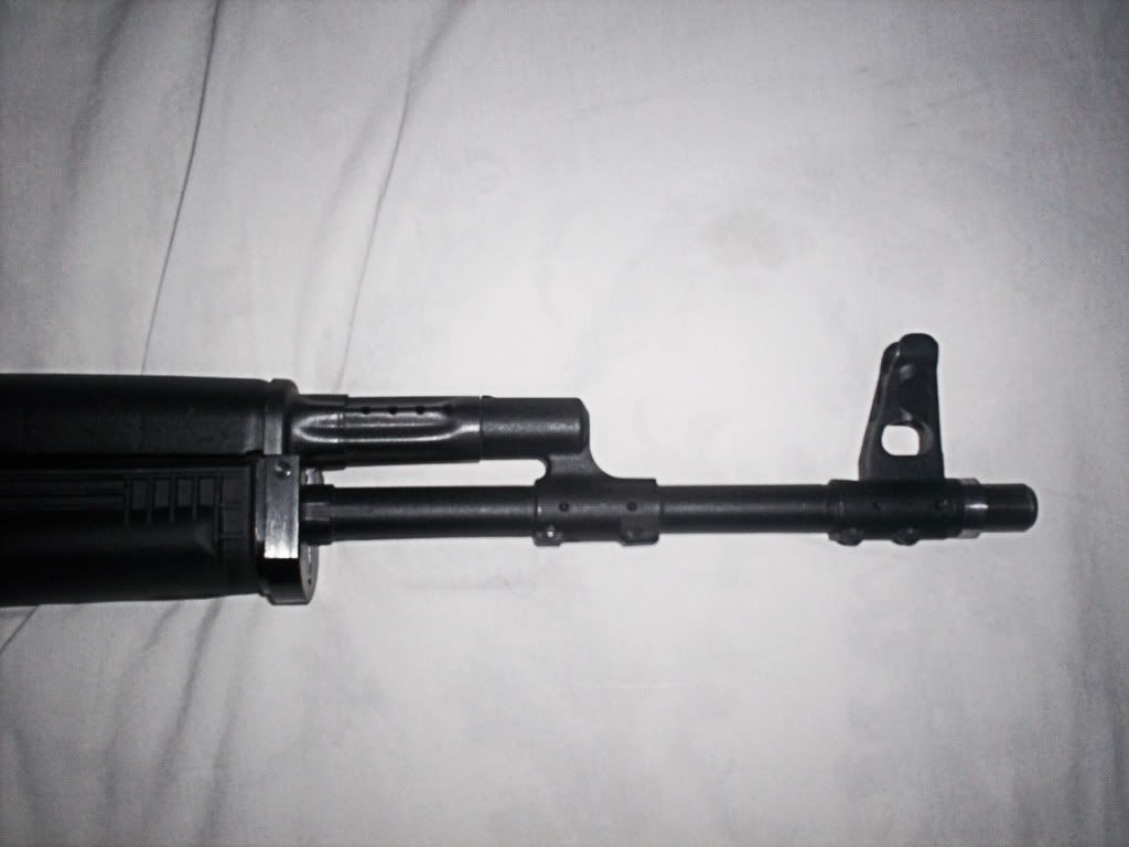

      Here is my build. Not as AR as your pic. But mine has a Galil armgaurd which is also not classic AK.
      These sites are real helpful:

        I like the handguard...could you mount a bottom rail to that somehow? Anyone else have some components/pics setups?

          No you can't mount anything underneath or anywhere else on armgaurd. That's the drawback. I wasn't interested any anything tactical. Maybe a scope, but I have a mount on the gun itself.
