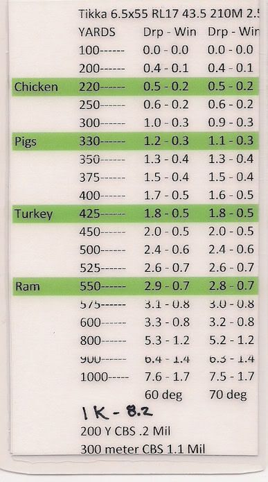

                    Once you know the ballistics of the load you want to use you can create a dope card for quick reference that will tell you how much to hold over/off for various distances and amount of wind at those distances. Here's just one example of a dope card in mils:

                          To answer your question quoted above, in the days before mildots a scope had a simple X reticle or some kind of post, (it might have had some kind of adjusting mechanism for el/wind). An experienced shooter would know how far his bullet would drop - in inches - at a certain distance. When sighting in at a target he would estimate how far away the target was by comparing it to the size of his reticle. As an example: At 100 yards an average human torso might be 5 times wider than his reticle. At 500 yards it might be the same width as his reticle. So if he was sighting on a target that was 1/2 the width of his reticle he would know it was 250 yards away. The shooter knew from his data of previous experience (DOPE) that his bullet would drop 15" from his zero distance at 250 yards. So he would "hold over" his target by what he visually figured was 15" to make a centered hit.
                          A human silhouette target at 800 yards through my 4x WWII sniper scope. (and yes, I can hit reliably at that range with that rifle and scope)
                          Optical range finders have been used for hundreds of years (mostly for artillery and naval guns), but even man portable ones are bulky and cumbersome. (see pic) They are accurate, but not typically accurate to within the small kill zone needed for a bullet. A few dozen yards one way or the other when you're sending a 16", 2000 lb. navel shell won't make a difference.
                          A sniper in the field, or his partner, could not easily, quickly or safely use one since the whole idea of a sniper is to remain concealed and get off quick accurate shots.
                          Then someone came up with mildots for a rifle scope. I won't go into the science of it since that is explained in one of the reference links I gave earlier, and they also explain the differences between mils and moa.
                          Now a sniper had a built in range finder, which when used precisely can be accurate to within +/- 5-10 yards distance wise at 1000 yards (based on personal experience). That is accurate enough to allow a Center of Mass (COM) hit on a human torso.
                          Now that the sniper has his mildots on the reticle, someone else realized that instead of calculating how much a bullet would drop in inches, they could figure it in mils. Once a shooter knows how much his bullet will drop in mils at a given distance, he can simply use the mildots to "hold over" to account for the bullet drop instead of dialing in his elevation change, and make an accurate shot. As an example: From the chart I posted, if I ranged the target at 450 yards, I see by my chart that my bullet drop is 2 mils. So I would center the second mildot or hash mark below the cross hair (hold over) on the target and send a round and hit the target.
                          The mildots can also be used in the same way to account for wind drift of the bullet.
                          Given the time to make a precise calculation of distance and wind effect, dialing in the elevation and windage will allow for a more precise shot. That's why bench rest shooters typically have 1/8 moa divisions on their scope knobs. To be as precise as possible. A sniper in combat is looking to remove his target from action. Normally that will mean a COM shot. Which, even at 1000 yards is about a 2 moa / 3/4 mil size target area. But if one has multiple targets to hit, and has to shoot and move quickly, using the mildots or hash marks will get it done reliably.
