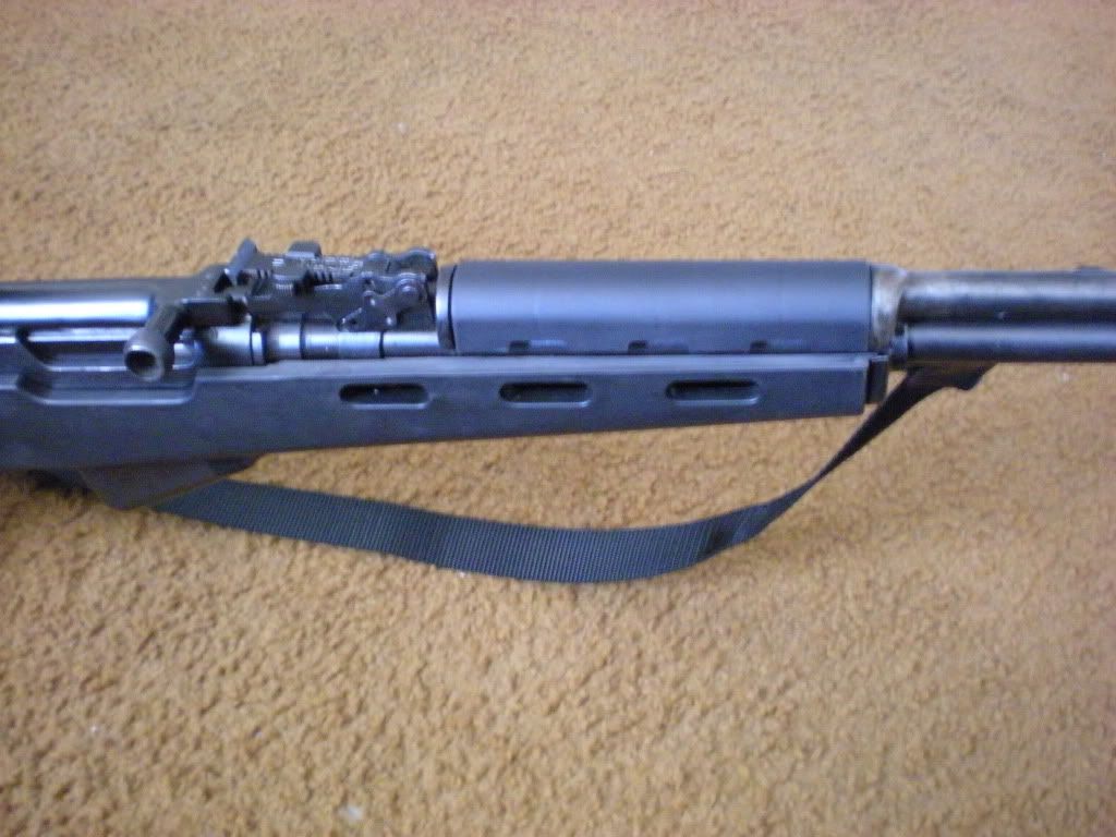

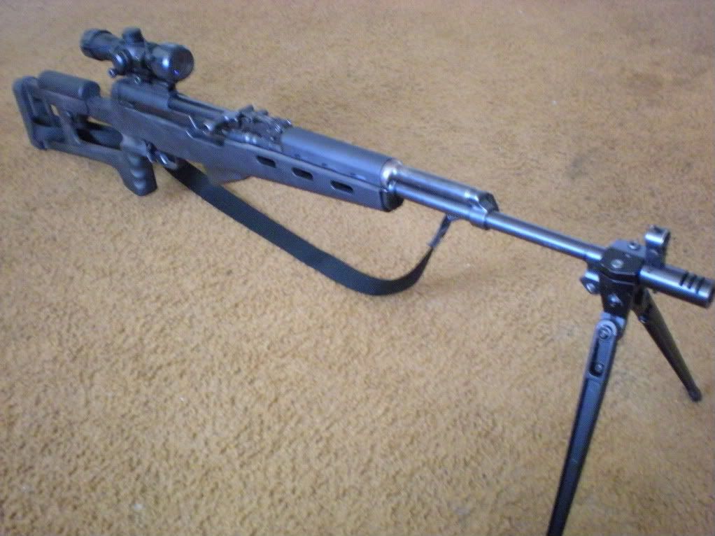

    I'm looking to put a mount and scope on my Russian SKS.
    This is what I have so far:
    I would like to do something like this:
    I will need to buy a Shell Deflector, mount, scope.
    Does anyone have any reccomendations. I'm going to be shooting 25-100m.
    Please supply links if you have them and I'm looking more towards lower priced items since im spending most money on my AR.
    Thanks
    FYI, the mags are fixed the picture just shows them both out.

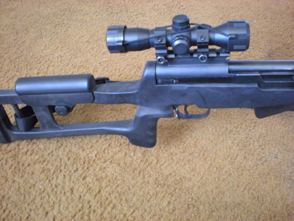

            I have my sight WAY forward but I like it. Mine is on the UTG rail and has been really secure. If I had it to do over again, I'd do the scout mount over the rear sight.
            Here's my set up, sorry if it seems like spamming to all who have seen it (just so happens everyone asks about Tapco and scopes and I have both)

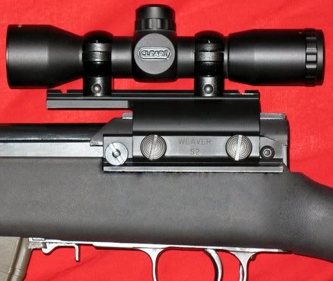

                          If you're feeling adventurous, do what I did to my M59/66. I used a Weaver converta-mount shotgun mount. Trimmed the rail to fit my receiver, then drilled and tapped it. it's detachable and hold zero. I now have a Red Star 4x compact scope on it, which allows the use of stripper clip loading. http://www.weaveroptics.com/rings_ba...ertamount.aspx
