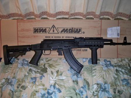

              From the back of the receiver to the barrel is 25" on my Saiga. Gotta come up with 5" of stock. Unless it is a side-folder you should be more than 30" with an adjustable AR-style stock.
                icefire
                • 172
                I have a T6 on my saiga, and it measures more than 30" even when fully collapsed. So, as long as you have a bullet button, (I recommend the PRK for any AK), and stick to 10 round mags or 10/30's you are good to go!
