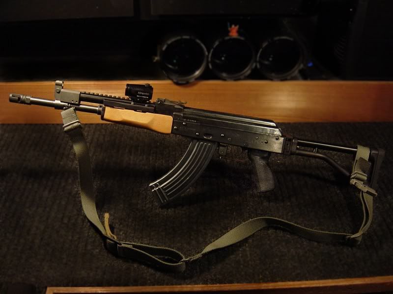

                    I have a Bulgy AK74 AR/AK hybrid that is very similar to Travis' build, less the ambi charging handle. I have seen the pictures and the ACE pig nose adapter does allow the stock to close almost fully against the rear of the rifle. That said I don't mind the VLTOR that I am using now. I also like the QD mounts built into the VLTOR.
                    My issue is the angle of the rear stock. With the VLTOR it doesn't follow the line of the receiver, instead it is angled upwards around 5-10 degrees. If anyone has any better pictures of a build using the ACE that would let me see the angle of the buffer tube I could decide if it is worth making the change.

                      The face of the Ace adapter is perpendicular to the receiver. I don't use the setup you are interested in but the skeleton stock comes straight out from the Ace, I dont see why a pig-nose and buffer tube would be any different.
                      The picture below is in the Ace gallery, looks straight to me.
