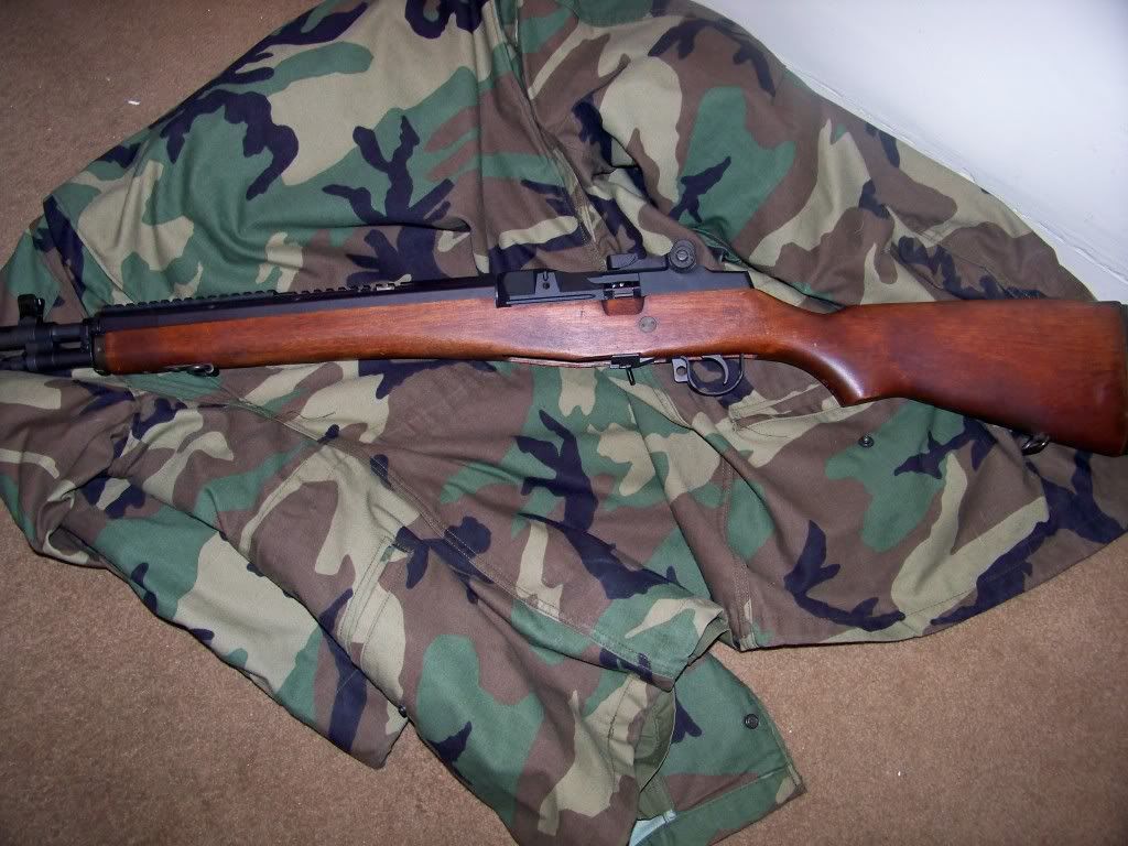

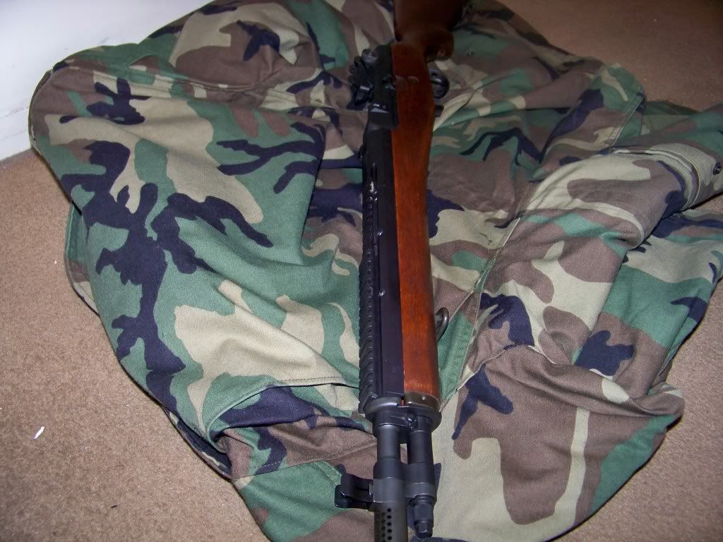

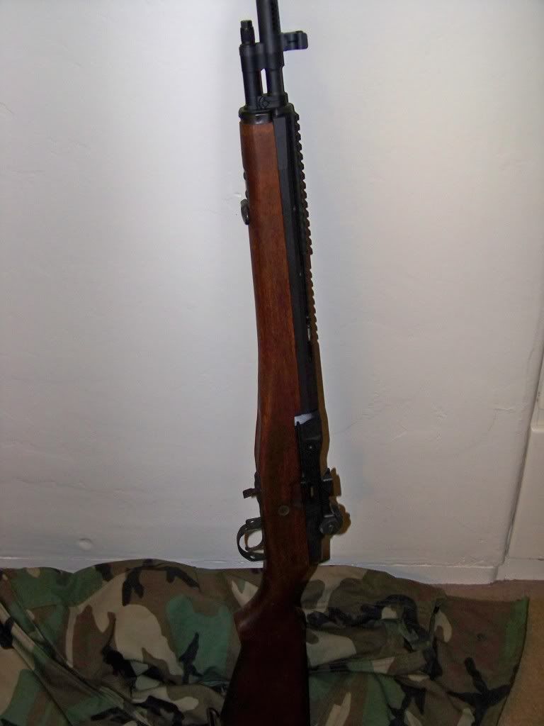

          Im guessing the one you saw in the market place is mine.
          I purchased the stock off a fellow calguner and was lucky enough that it came with all the hardware installed.
          Currently I'm thinking of not selling as I really do like the looks. Aww the battle between projects and cash flow.
          Here is a picture of the stock liner:
          And here is a picture of the action in the stock.
