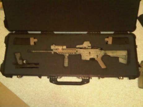

                        This job took all of 20 minutes with a snap-off blade utility knife fully extended.
                            If you want perfect ("non-jagged") cuts, you have to use a hot wire. Yours looks fine with the weapons installed, but how do the cut edges/walls actually look like? For the perfectionist, this won't do. But that's just me.

                              sacshooter1
                              • Aug 2008
                              • 113
                              Perfect lines cut in foam? Really, why would someone care about how someone's lines look cut into their foam. I cut mine with a electric knife and I am willing to bet that it holds my AR just as tight as someone who used a hot wire gadget. I'm a perfectionist when it comes to my guns, but I never really thought about the straightness of my lines in my gun case until this forum. But that's just me I guess.
