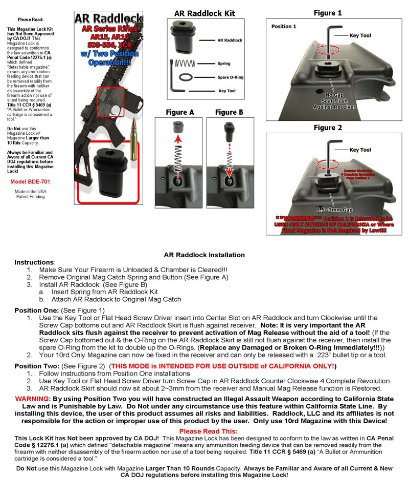

    Gen 1 Maglock questions
    Ok guys bought a gen 1 what I believe is a Radlock for my ar build and Im not quite sure how it works...
    How do you put it on and
    How do you release your mag
    Im still waiting for my LPK from TDS in Loomis so no mag catch to actually try it out.
    Its the one with the set screw and tiny little allen.
    Any help is appreciated guys.

    This one?

      If it's the Prince 50 lock, the one that looks like an actual push button with a set screw, then ditch it for an actual bullet button magazine lock. Prince 50 has a BB also.

        The one to avoid.

          Dangit I knew I should have double checked...
          its this one
          The Prince50... Please forgive my n00bness...

            Wow, the one I got the one to avoid....
