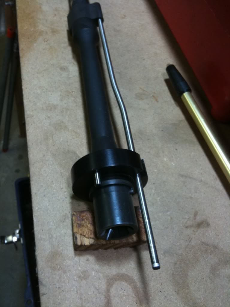

                I am just finally getting around to posting up some detailed pictures of how this thing works.
                Here you can see the fore end lock ring as it sits on the barrel. They do sell these extra too just in case you want to quick swap barrels.

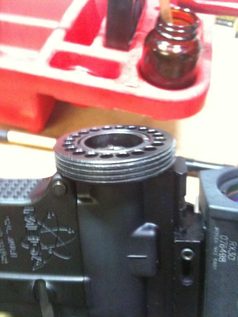

                This is the quick change barrel nut.
                Here is what the system looks like when you put the barrel into the upper receiver.

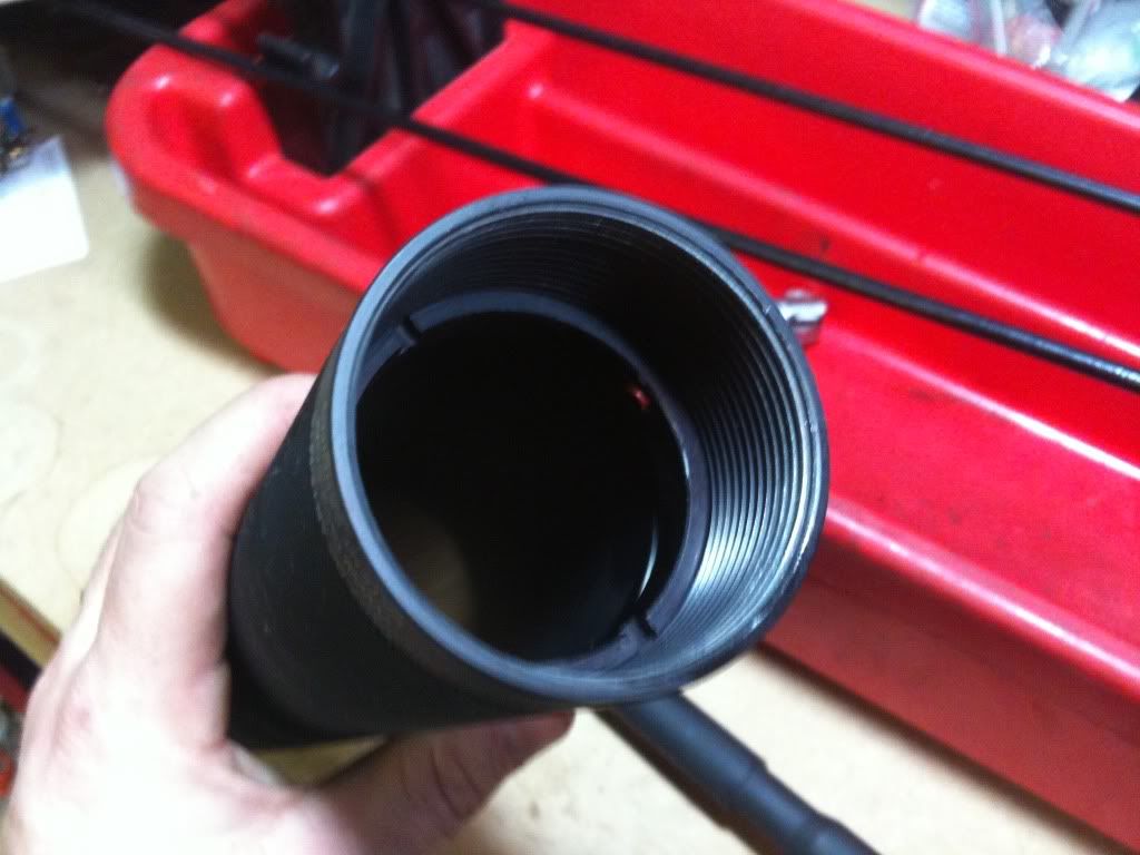

                The free float rail. Note the machining inside that provides the ledge to secure the fore end lock ring into the quick change barrel nut.

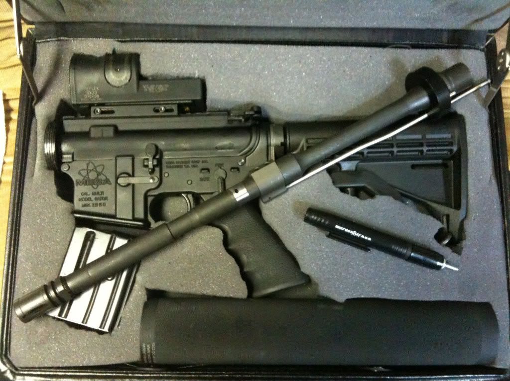

                And the final product. This is how I carry mine. I did put a Bullet Button Wonder Wrench in the case too for my trip to Vegas this week.
                I will do some tests in the near future to see how it holds zero. I am wondering if I shouldn't put a nice scope on it just for the tests so the test can be a little more precise? Nah, lets stick to the way I am going to shoot it rather than a hypothetical. I will get it shooting right on at 100 yards using the Trijicon and then I will shoot a 10 or 20 round group and then take it apart and put it back and repeat.
