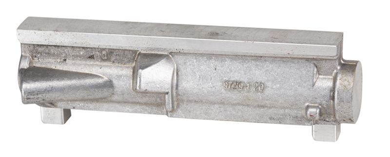

                        The forging mark is imprinted by whomever turned raw bits of Al into a molded hunk of metal that only somewhat resembles the outer look of an upper. It looks like this:
                        Then it's cut, anodized (and often assembled) by one of the major manufacturers/cutters, not by whoever put the marking there.
                        The upper receiver is then assembled into a complete upper or rifle by one of many rifle manufacturers, not by whoever put the marking there.
                        Forging marks = meaningless with respect to who made the complete upper or any of its characteristics of quality.
                        Your analogy is simply wrong. Oh, but nice attempt at a quip by ignoring reality.

                              Go look at the picture I posted of the raw forging. Look just above the front of the tube for the forward assist. Do you see the little cardinal looking dookie-doo?
                              That's a Cardinal Forge forging mark. If it were Cerro, theirs would be on it. The forging mark is put into the metal before any manufacturer does anything to the upper - including the cutter.
                              Some manufacturers do engrave the upper with additional marks. Colt is a good example. In this picture you can see the Cerro Forge marking in front of the Colt C-engraving.
