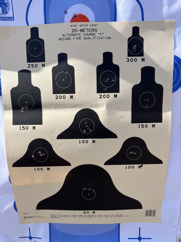

                A couple of good targets for 25/300 meter zero and target shooting. I use them from time to time.

                        Flouncer
                        • 1309
                        Stormvet, I am unable to find that first target, the ALT-C(2). Do you have a source/link ? - thanks

                          smoothy8500
                          • 3846

                              Flouncer
                              • 1309
                              Smooth !!! Thanks.
