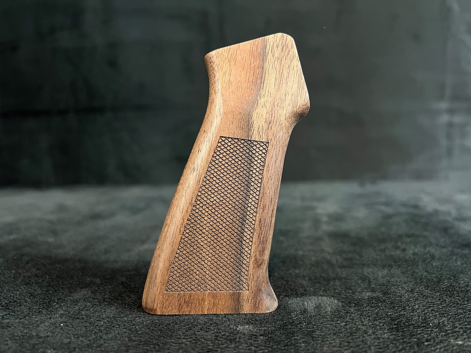

                          They do look cool...
                          We manufacture premium grade wood stock sets for the AR-15.
