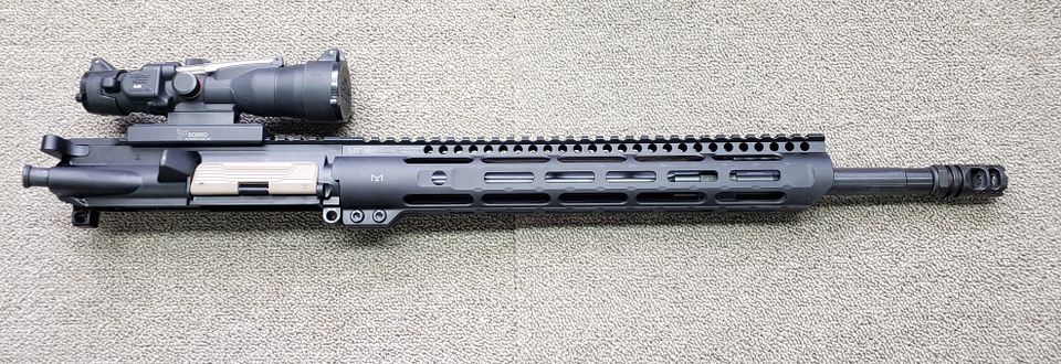

    Last year during some of the "Black Friday" sales I bought a bunch of AR parts from different vendors with the intention of putting together a few uppers. A few weeks ago I finally got around to putting a upper together using some of the discount parts. It went together easily and head spaced perfectly.

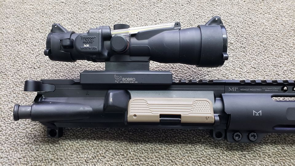

    I mounted a Trijicon TA33-C 3x30 ACOG with a amber chevron and a BOBRO QD mount on it for this test. I'm going to leave the TA-33 on it.

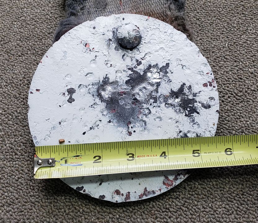

    I set up a 12" and a 6" steel plate at 100 meters. I had already bore sighted the upper on my property, so I knew it would be close to being sighted in.
    It took me about 15 rounds shooting at the 12" plate to get what I thought was a pretty good zero using first some surplus M193 5.56 ammo then some ZQI SS109 / M855 "penetrator" ammo.

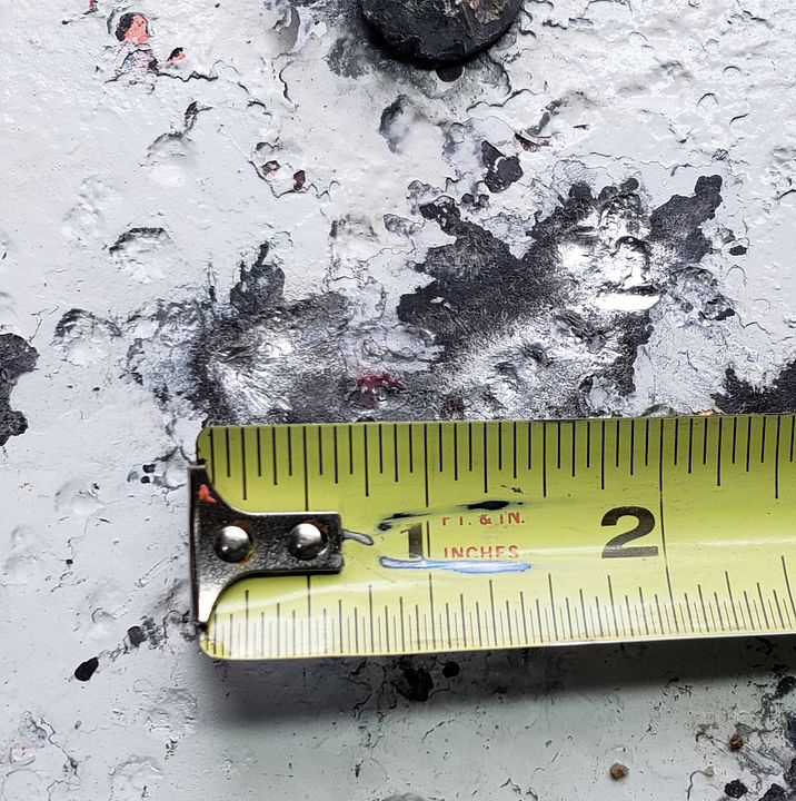

    I then shot 10 rounds at the 6" plate using the ZQI M855 ammo. The results were pretty startling considering the barrel only cost $79.99.
    Right at 2" . I was shooting prone using a sandbag on top of a ammo can. The Larue trigger helped a lot, and I really like the feel. Not to light, and very crisp.

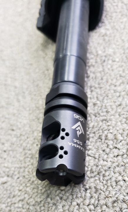

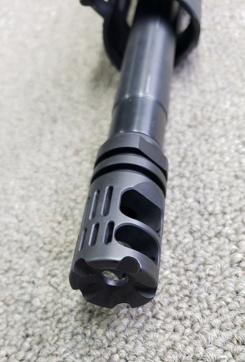

    All in all I shot about 100 rounds of various brands of ammo and didn't have a single malfunction. Ejection was very positive and the VG6 Gamma brake reduced recoil to virtually nothing.
    So you can build a very accurate and reliable upper at a fraction of the cost using good parts bought on sale, and assembling them yourself.
    I'm probably going to buy a few more of these barrels as spares.
    Here is a list of the parts as well as their costs:
    Upper receiver, stripped PSA "blem" (actually a Aero precision upper) $39.96
    Barrel, Ballistic advantage 16" 5.56 Gov profile mid length gas system 1-7" "modern series" nitride finish from Primary Arms $79.99
    Handguards, Midwest Industries MI-SLH 12.625" Mlok slim from Aim Surplus $127.96
    Muzzle brake, VG6 "Gamma" from Primary Arms $39.99
    Bolt carrier group, "Toolcraft" Carpenter 158 Nitride from PSA $69.99
    Charging handle, PSA $9.99
    Gas block, "KAK" from Aim Surplus $12.00
    Gas tube, Anderson from Primary Arms $8.99
    Forward assist assembly, from PSA $12.95
    Ejection port cover, Strike Industries "Ultimate" EZ install. $16.95
    Total $418.77

        Good job! So 2" at 100 yd is about 2 MOA.

          Extremely good for SS109. I'll have to shoot it at paper to see what it can really do, but I'm very happy with 2 MOA using the ZQI penetrator ammo. I've found it to be pretty accurate in other AR's. It's to bad it's no longer being imported.

                        Oh, and the BOBRO mount I got with another ACOG I bought here on Calguns... It was basically free. You can get them new on the net for $130
