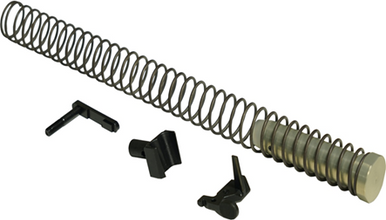

                • #38
                  verdigris
                  • Feb 2019
                  • 302
                  The bolt for the CMMG also comes with 3 different weights to add to the bolt to fine tune it at well. They are added in the back of the bolt carrier.

                      • #41
                        ysr_racer
                        • Mar 2006
                        • 12014
                        This is what I ordered, and what I got. I don't quite get adding weight, don't you want the lightest bolt carrier group you can get?
                        My buddy runs a 1oz buffer, and it's really soft.
                        • #42
                          verdigris
                          • Feb 2019
                          • 302
                          I just pulled this off the website. I run the 5 inch barrel vs a 16 inch so added 11 inches probably softens it up as well. Don’t know how to post without attachments but here are a couple screenshots below. Mine came with it didn’t pay extra maybe it’s just a separate item now.
