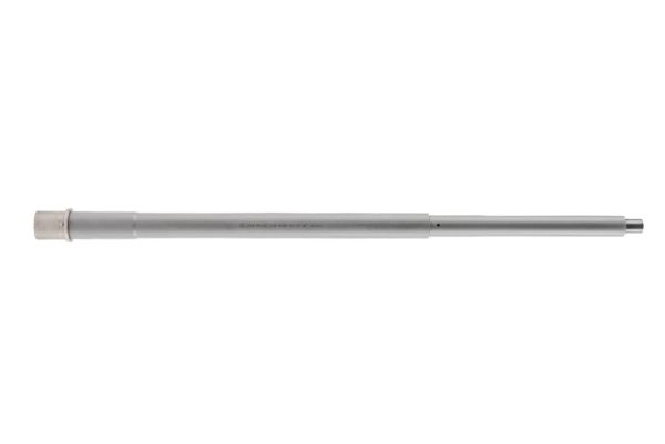

            I'll throw this out there. Though I know it's technically "rack grade" by most people's definition. Might not be quite as thick behind the FSB as an HBAR, but it's still beefy:
            20 inch 223 Wylde rifle length AR 15 barrel. Distinct rigid pattern profile in 416 Stainless steel
            Reasonable price and it's in stock. I have it in 6.5G and it shoots very well with my handloads. (Sample of just one, of course.)

                  Yeah that makes sense. The BA barrel might shoot fine; depends on that one sample, and what expectations are. Could get a person's foot in the door of competition anyway, until UPS finally drops off that box from WOA. But ordering two barrels at once instead of one really blows the budget.
                  I have two Green Mountain (GMR) barrels. Well, three if you count my SixFive Arms 4150 16" Grendel barrel, which was made under contract by GMR. My two .223W barrels from GMR shoot very well. 18" and 20" medium profiles. I wasn't aware that they make an HBAR though. Is that a special order?
