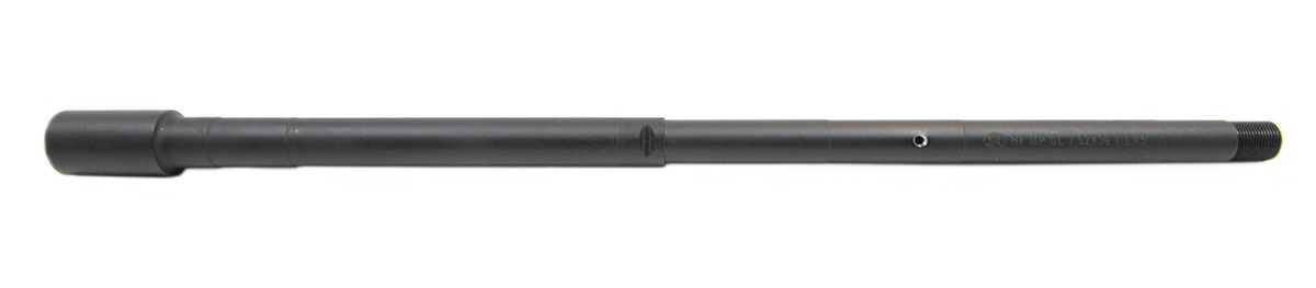

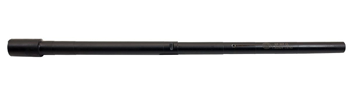

    Then I'm adding a Palmetto State Armory FN barrel, cut to length.

      Make sure your donor barrel does not come with a gas port already drilled as the jmac block might not cover up an AKM angle drilled hole.
      Also make sure your builder will recontour the barrel for the Jmac block as a proper AKM barrel won't be profiled far enough back for a 90 degree block.

        Your Integrated Front Sight Base / Gas ( FSB / GB ) block may be an issue.
        Your parts kit features a 45Degree GB. The GBC13 GB is a 90 Degree unit.
        The gas port may need to be corrected.

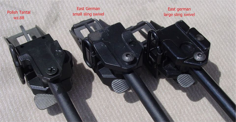

            That EG folding stock looks like the 5.45 version.
            Yes there is a difference. It's in the size of the sling loop and finish.
            The 7.62 folder has a smaller loop and a duller finish.
                Hmmm, not sure if PSA sells them undrilled for a gas port. I have basically two choices:
                https://palmettostatearmory.com/fn-h...47-barrel.html:
                and
                https://palmettostatearmory.com/ak-1...ome-lined.html:
                I'm not sure what the differences are. The gas port locations seem to differ a lot. Maybe it's worth ordering both and comparing them side by side?
                When guys convert guns by using the Bulgarian combo FS/GB, they don't have to reprofile the barrel, right? I probably should ask JMac.

                  ar15barrels
                  • 57032
                  and
                  You need a 100 series (103 or 104) barrel to use the 100 series jmac gas block.
                  You do have to reprofile to move from an AKM to a 100 series gas block on many barrels as well as close up the AKM angled port because part of the port peeks out from in front of the gas block.
                  I have one such job on my shelf right now.
                  You do not need to reprofile when re-working a Saiga as a Saiga already has a 100 series gas block.
                  Randall Rausch
                  AR work: www.ar15barrels.com
                    beanz2
                    • 12032
                    Thanks, Randall! I opted for the 103 barrel. Hoping PSA will stick to true 100 series specs.

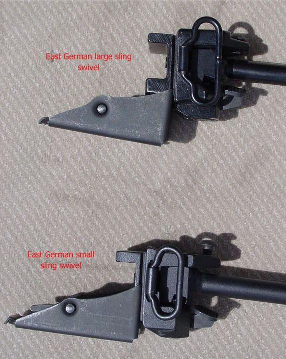

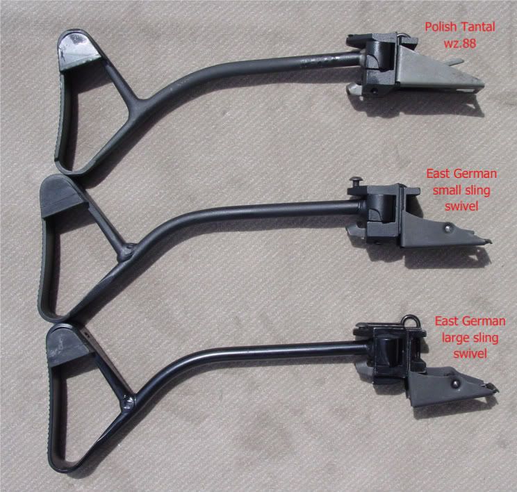

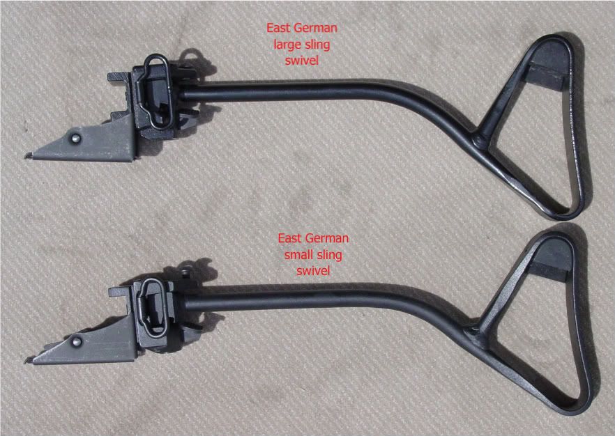

                      Here is a side by side comparison of the two different EG side folding stocks. The 7.62 is the small sling loop. This stock has a almost parkerized look to it's finish, as compared to the 5.45 which almost looks powder coated and shiny. The actual metal block that fits into the receiver also has different casting.

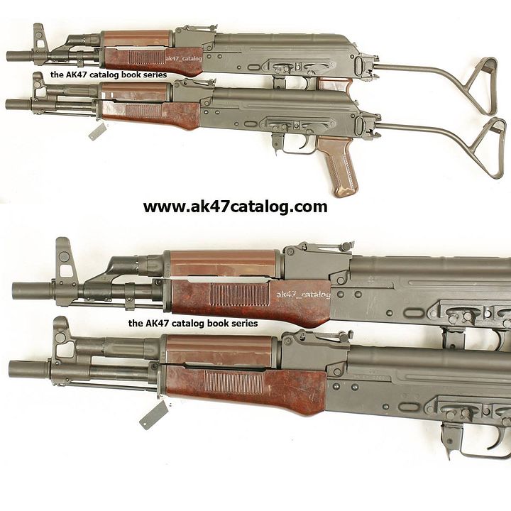

                        A pic I found on the web... Actual rifles not clones. No bumps, at least on the left side below the trigger pin. Are you going to get a optics rail?
                        I coundn't find any pic's of the selector markings for the exact rifle you want... But most of the 7.62 selector notches look to be "straight" meaning parallel to the top of the receiver.

                          Awesome reference, SVT-40! Ok, no trigger hump then.
                          Yes on the side rail. Those OG optics rail will be hard to find. I have nothing that looks like them, the closest I have are Bulgarian rails, but the central depression will not be oval like those in the picture.
                          The external appearance on the stock hinge looks close enough. If needed, I can see if I have a suitable sling swivel donor. I still need to find that missing wire stock, dang it
