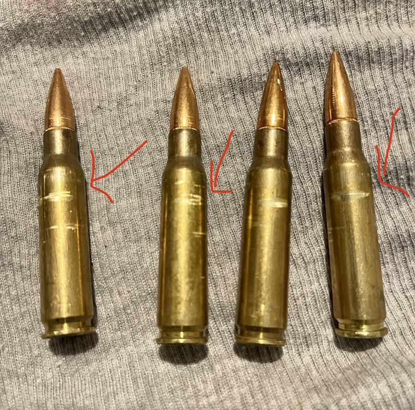

*Updated* Marks on Casing..??

    I would stop
    A new rifle should not make those marks
    (thanks to Jeff Cooper)
      hermosabeach
      • 19110
      I would stop
      Pull the bolt
      Run a q-tip into the bore
      Do you find a burr?
      Cover a round with sharpie- all black
      Sharpie will scratch off easily
      Load a round into a mag and push out by hand. Same marks?
      Re coat with sharpie- load round into mag. Slowly release bolt and load 1/4 of the cartridge. Then eject the round.
      Do you see the marks yet?
      Blah blah blah
      Safe direction for ND
      Eyes and ears
      Use dummy rounds not live Ammo

        Ran a cotton swab, shine a light and looked inside chamber, nothing
          toiletfighter
          • 3870
          Metal mags? Maybe the round is rubbing the feed lips?
          Just a wild guess I pulled out of my ***.

            baih777
            • 5679
            Feel the inside of the mag lips to see if there is a burr.

              I agree that it's the magazine lips.
                Ignore the marks. That's what slow hand cycling the action will do to brass.
                Go shoot it. If those marks get worse then you may have some burrs to take down.
                You'll be amazed how this little crap disappears when the action is cycling at normal speed.
                  Gen 3 10/20rd Pmag

                    Can you feel the scratches with your finger or are they just light surface rubs?
                    I would shoot it.

                      Light surface rubs

                        I had a DPMS that put marks similar to those on the cases, both handle cycled or fired. I never found any defects in the chamber and it did it with the factory metal mags and P-mags. I put a lot of rounds downrange with that gun and it never changed. I figured it was rubbing on something as the cartridge fed from the mag into the chamber because it didn't show up if I fed a single round directly into the chamber and let the bolt slam home.

                          I wouldn't worry about it. See how it shoots.

                              I would shoot it myself. I have noticed that hand cycling vs. normal fired cycling always leaves different marks on the brass. Truthfully, I would be more concerned had there been no marks at all after hand cycling. Brass is soft it will get marks on it when rubbing against steel. Enjoy the rifle it looks nice. I know you said it was a PMag but in the pic it has a metal one. they could have happened before, and you didn't notice?? They do look like mag marks to me.
