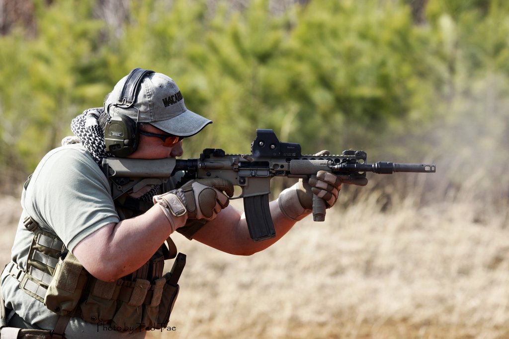

          You are on the right track as far as adding a vertical grip to your existing M4 style handguard. you will need a add-on rail in order to mount a VFG to your existing gun...
          Currently AAC has the best 1913 rail spec adapter on the market, it is not too expansive and it will do the job.
          However, i would actually recommend investing in a Magpul MOE handguard. it has a provision for an add-on rail adapter. this is an inexpensive option so you can just run the VFG on your M4.
          Rail system is an investment, but if you just want to mount a light and VFG, the MOE is your clear winner in utility and budget.
          If you have the $$ to spend on a rail system, the best choice for installing a rail with free float capability on to your M4 upper without any major modification would be the Daniel Defense Omega rail system...
          Either way, the Tangodown is the best VFG on the market by far, and you can run a simple Surefire 6PLED light with a Vltor flashlight mount. low cost and good to go with plenty of light and battery life.
          I ran a Tangdown VFG and a SF Scout light on my MRP
          Taken in South Hill, VA. M4carbine.net / Larry Vickers Carbine Calss
