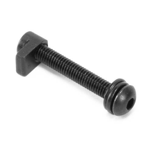

                  This one worked perfectly on my Vltor EMod
                  The Aim Sports M4 Stock Lock Pin is designed for featureless conversions of M4 and similar style buttstocks into the locked position without modification or marring of the existing components.
                        https://www.aimsportsinc.com/m4-stock-lock-pin/
                        so you basically remove the lever and when you get to a postion you want you loosen the screw to send the plunger down?
                              Remove the lever, spring and plunger and replace with the stop and bolt. The photo attached is what you take out and the card that comes with it showing how to install. I left the lever off though.
