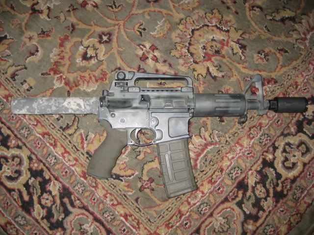

          One drill press per person and maybe you could do it. Otherwise you have a lot of people standing around watching someone dull drill bits. Also many of the 80% lowers these days are coming with un-milled fire control pockets, that requires CNC's jigs milling adaptor and time, time and more time.
          YellowLogics lower from the first batch, second batch is now done Blaine is a great guy to deal with. Look you get a single shot sled with your paperweight!
          Using CNCs jig and milling adaptor produces this in only 10 minutes ( just kidding!!!)
          Noveske Pig, 10/30 P-Mag, spikes pistol buffer set wrapped in bandage material, and of course krylon
