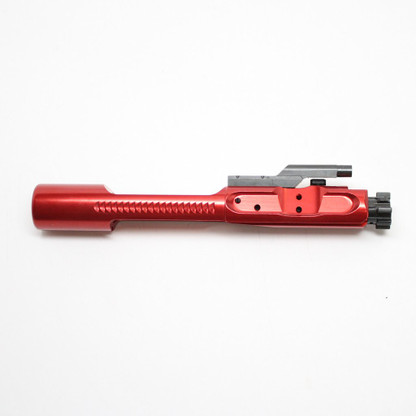

          LW BCG 125 (AIM) 250 (Faxon)

                  Bcg - 5.8oz - $177
