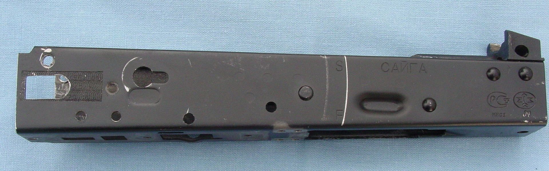

    I had planned to have the conversion done by Rifle Dynamics, but today they told me that they will not do a Saiga conversion anymore as a proper conversion would require cutting holes where there are importer markings towards the back of the receiver. They would be happy to do the conversion with a Childers receiver, however.

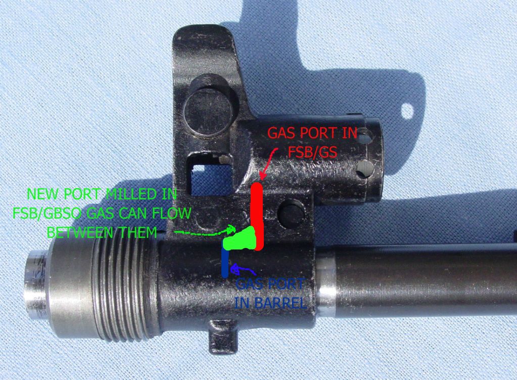

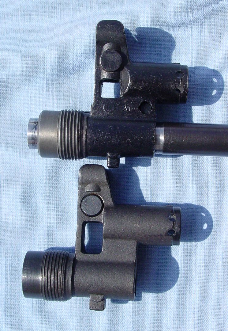

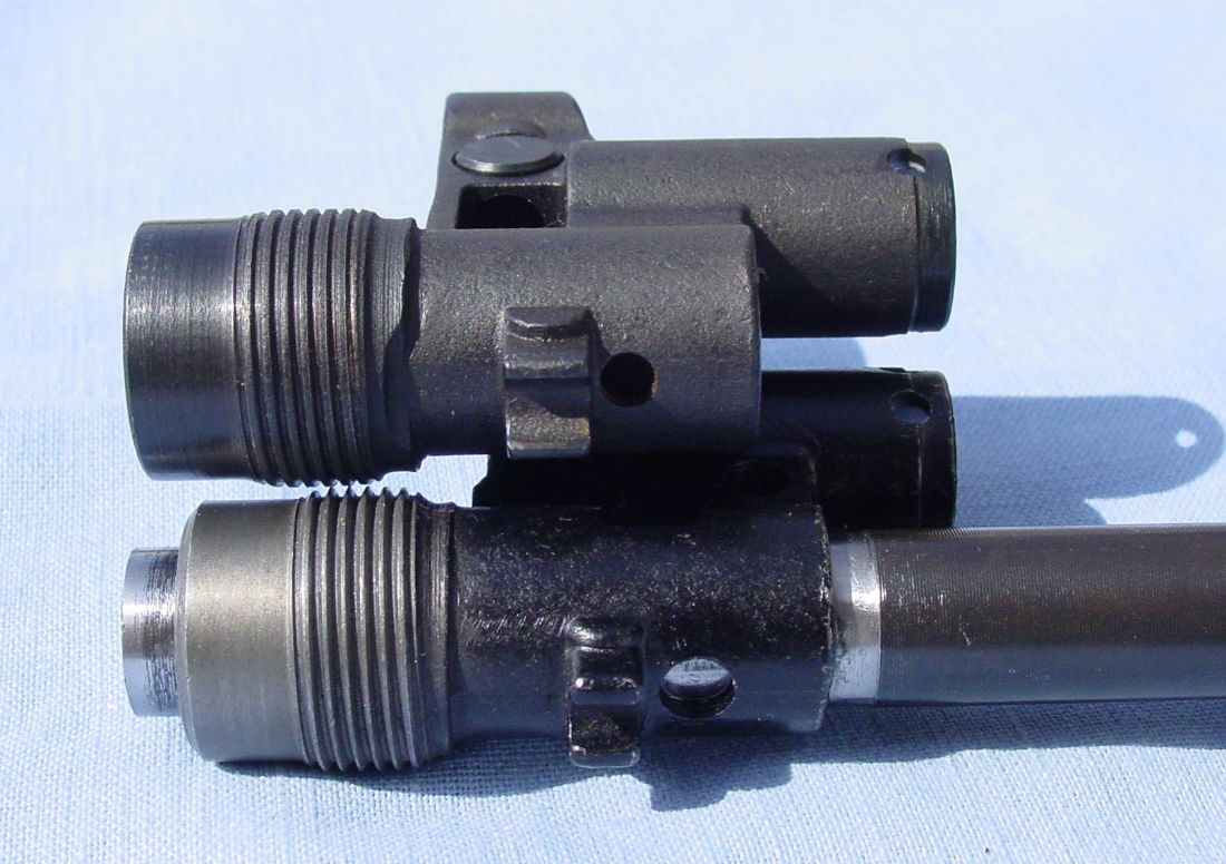

      Russian and Bulgarian FSB/GB's Russian above Bulgarian below. You can see the differences. The different lengths necessitate a bit of work to get the gas hole in the barrel to lineup properly and still allow the gas tube to fit properly.

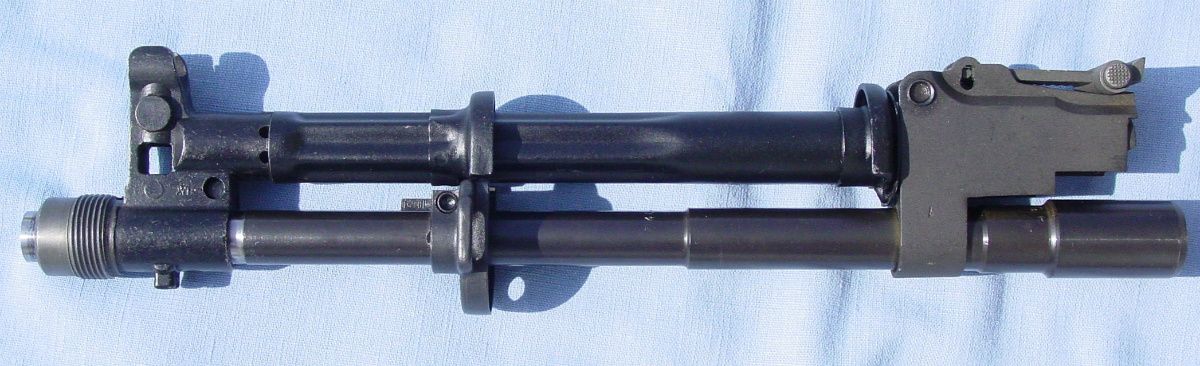

          These are the parts I have on hand:
          Sorry for the large pic, but I want people to see the details and tell me if something is incorrect.
          Now, the stock optics rail is removed and is on the right top corner with others that I happen to find in my parts bin. Which one is the correct optics rail to use?

            The original scope base looks from the pic's I've seen to be the best match.

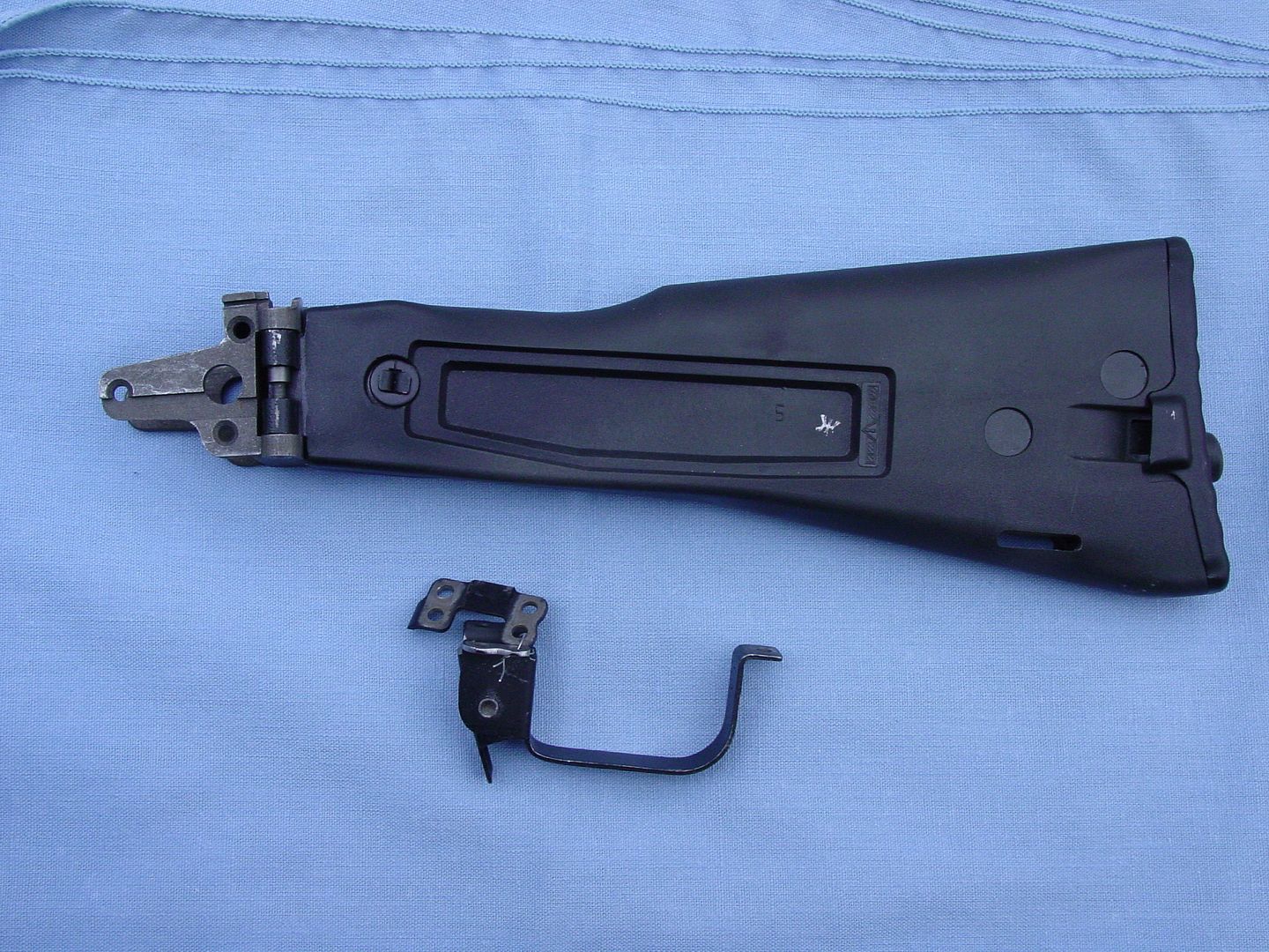

            You also need a 5.5mm Russian solid folding butt stock. The AK-105's didn't use the metal skeleton type.

              I have a solid 5.5 mm stock, I'll switch them around. I just love the triangle stock looks. Same with the stock cover, I might use it. Thanks for the suggestions!

                You should be able to place the FSB/GB along the barrel and see how it's gas port aligns with the port in the barrel. Then put the gas tube in it's place on the FSB/GB and see how it aligns with the RSB...
                You can see the issue I had in the pic's below. The maid issue was I was using a Bulgarian actual AK-105 barrel and a Russian FSB/GB.
                You may not have that issue as you are going to use the original Russian Saiga barrel.
                Bulgarian resting on top of the installed Russian FSB/GB. If I had placed the FSB/GB so it's gas port was in line with the gas port in the barrel the gas tube would have been to short. It was easier to mill out the inside of the FSB/GB sothe port in the barrel aligned properly (as in the pic above)
                Poke'm with a stick!

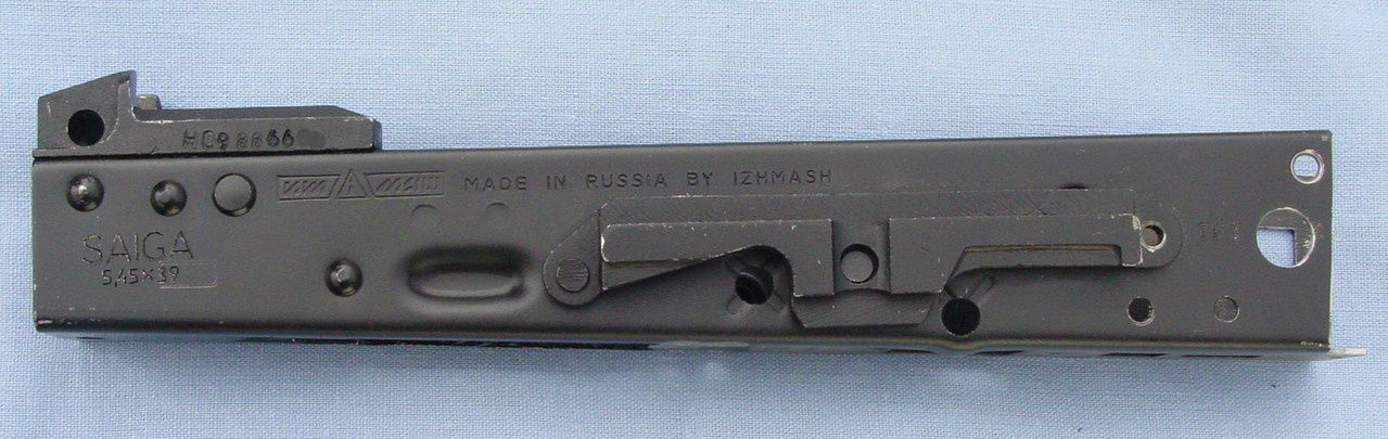

                      What I hate is the velcro stampings or the RWC stampings on Saiga rifles that are in the way for the sidefolder rear trunnions to be fitted and drilled
                        The Shootist
                        • 1796
                        Me too! Have one on my 5.45x39 and I was like ok....there is that.
                          Yup. I could have started with an Arsenal SGL31-94 that has all the stampings on the right spots, but I'd rather start with an ugly duckling like the Saiga Sportster. The work with the SGL31-94 would be a lot less, but the end result wouldn't look too different than what I start with.
