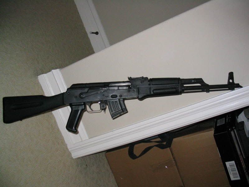

    Finished My First AK
    Hey everyone, I have been a lurker on this board for some time, and it has led me to 2 OLL ARs and 2 AKs. From advice here and on other forums I have somehow managed to build myself the first of two AKs
    It is a Romanian with US furniture, Tapco FCG, BBQ Paint finish, and a copy of morepoop4u's mag-lock. I did it with U-drives and button screws. Haven't shot it yet (hopefully this weekend), but it cycles pretty smooth.
    Thanks for all the advice on this great forum for California shooters!

    looks nice. It should be a lotta fun. But that being said, screw builds are icky. Gets some rivets and some modified bolt cutters for the next one.

      Definately looks nice. Im reading around on how to build these up, and wanted to pick up a YUGO parts kit. Every Romanian parts kit ive seen has that forward pistol grip ?? I dont see it on yours??
      Edit: Never mind =) I re-read your post and did a little digging

        Congratulations! It looks great, make sure to give us a range report after you break her in .

                    Where did you get your 10 round mags and do they function well?
                    Also did you paint the receiver?

                      From the picture it looks like a 5 rounder. They have worked very well for me in the past
                        Looks like a 10rdr to me....
                        I bought mine off CheaperThanDirt.com

                          Tis a 10 rounder from cdnn and yes I did paint the receiver as well. I cleaned all the parts with brake cleaner, steel wooled them, washed them with soap & water, and then heated each part up in the oven before painting. It was worth the effort.
