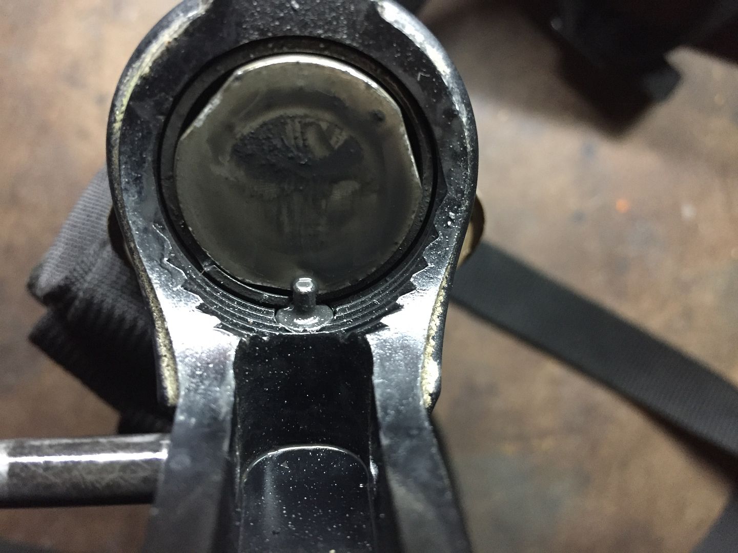

    Buffer retainer pin wear on one side
    Besides misalignment between upper/lower is there any other reason why a bolt carrier would wear one side of the retainer pin? The lower is spike's tactical and the upper is vltor. They seem to align perfectly. The BCG has some wear in the groove where the retainer pin made contact with one side of the groove.

            Give us a straight on shot like this

                Your threading looks wayyyyy off to the left. There is visibly more threading cut into the left side than the right. If the buffer tube is threaded in that far to the left, regardless if the buffer retainer hole is centered, the bcg is being forced to one side while cycling, which would put wear on the right side of the buffer retainer.

                  I'll be contacting spikes tactical with these pics and see what they say.

                            Not sure if it's the angle, but doesn't the buffer retain pin look farther in than the example given? I count 1.5 threads on the OP's between the pin and the edge of the trigger well, vs. less than a thread on CouchOperator's. Plus, the OP's buffer tube seems more recessed vs. CouchOperator's. Does a lateral shift like that make a difference?
